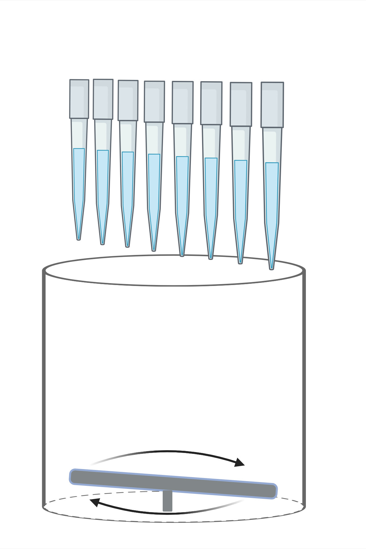

I’ve seen a module before, or at least the concept of one. Its basically a cylindrical reservoir that’s about double the height of a 300mL SBS reservoir. Its fixed and has a small horizontal metal piece inside that rotates to keep cell culture in the reservoir orbitally shaking and suspended. Its just wide enough that the 8-channels of the Tecan FCA/LiHa or Hamilton can fit inside (after stopping the rotator piece) to aspirate and transfer cell solution.
Anybody know where to find this? I swear it exists. I think it was most likely shown to me as a module addition for the Fluent, but I’m not 100% sure.

This is pretty cool, I’ll go explore the page just now - though for good measure I’m attaching a diagram of what I remember the thing looking like
@dReekb I am pretty sure the link you shared is exactly what I’m looking for. This will definitely have to be a fun 3rd party integration, but I think its the most (and only) elegant solution to keep cells spinning right round on deck.
