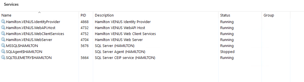

I’ve been working on a WinUI Desktop Application to serve as a monitoring dashboard for any number of hamiltons, instruments, etc. but am now wanting to expand it’s capabilities to serve as the primary interface a single system to be operated by multiple different operators for long runs.
My question is specifically around, which of the Hamilton Services (if any) can be updated to run under the SYSTEM account so that the processes continue to run even when a user is not logged in?

Hi Brandon,
unfortunately this is currently not possible, and requires several changes in the current architecture. It´s in our roadmap to be implemented in a future release (TBD).
