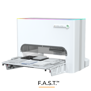

Might want to check out the F.A.S.T. by Formulatrix.

The F.A.S.T. is pretty interesting. Does anyone here have any experience with it?
We would be looking to integrate it as part of an automation module, so do you know if its able to be controlled not using their interface software.
Also i guess tip cost is another consideration as they look pretty proprietary.
Hey Steven, I have some experience with the F.A.S.T. It has an open API and can be integrated (Biosero and HighRes already have drivers). The software is intuitive and easy to use. The volume range for the low volume tips is 0.1 to 13uL and the high volume tips (they aren’t on the market just yet) are 0.5 to 50uL. Pricing isn’t available yet on the high volume tips but the low volumes are about $0.10 each.
