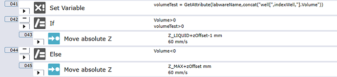

So after a bit of playing with this, I found there is in built volume tracking already in fluent control. All the calculate height is already done in the variable “Z_LIQUID”. The only issue I had was that if there is no well volume to start the calculation throws an error so I added in a condition to check if there is volume in the well.
I have implemented as outlined:

Also my impression was that Z_LIQUID was just the liquid detection height.
If Z_LIQUID is a software calculation made with the volume and well dimension, that’s good to know.
