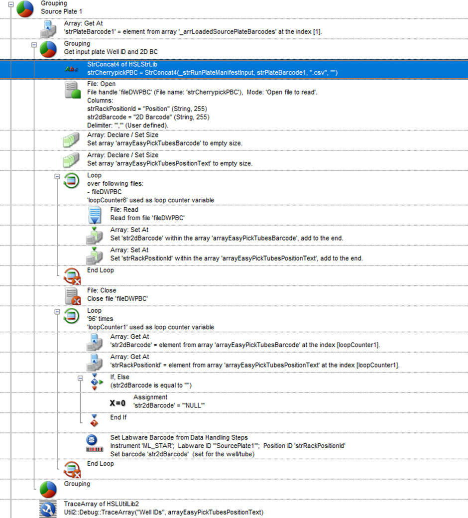

hope you can help as I have been trying to find the source of my error and spinning without any progress. The code that I am using is lifted form a previous cherrypick method I have utilised on several systems. basically the code uses the scanned barcode to find the file with individual plate barcodes, scans then in and applies them to the plate. I then use the data to create a copy of the file in a new location as a sort of parity check. I have used this to allow plates to move between methods and systems without the need to input sample IDs. I have attached the log and some images. hopefully someone will see something I am not.

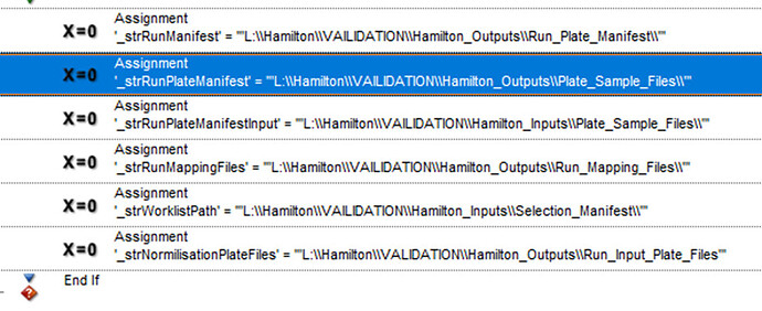

File path assignment
Input file parse

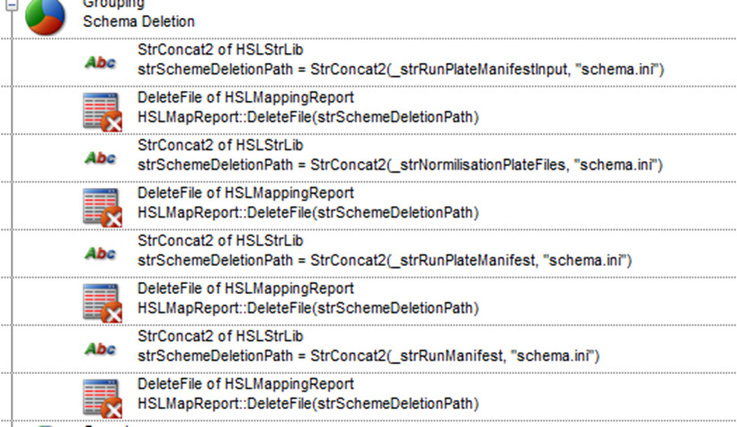

schema.ini deletion

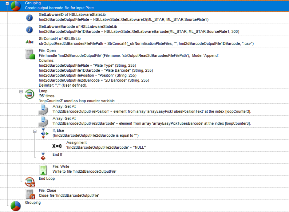

new file creation where error is appearing (same code worked before)

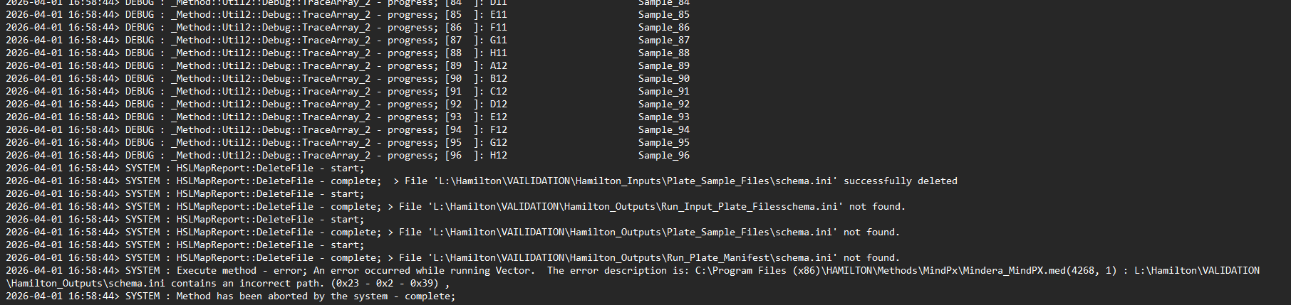

log trace

Just reviewed the error code and log again and noticed i was missing the folder information, Doh!
its missing \\, omg such a simpler error and i missed it, sorry for the trouble.
as an update I made the changes and tried the mapping setting that you suggested in the registry and it was still failing. I change all the file paths to local and it worked without error. So it is related to the mounted drive and must be something around that configuration. I will keep trying to see if I can find the issue.
