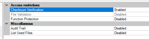

To prevent this kind of error, I would strongly recommend not using a temporary folder for methods/libraries and instead utilize function protection and file validation.
Thank I’ll try out function protection.

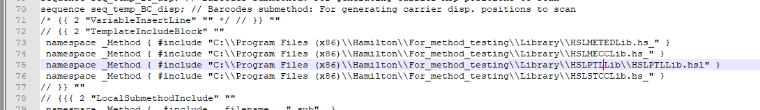

If someone really want to have methods, libs and labware in a separate folder during testing, you can edit the hsl file for the method.
  • Open in text editor or in Hamilton HSL method editor.
  • You’ll see the included libs with the correct path, past those and the declared variables you’ll see “namespace _Method” mentioned again for HSLMETEDLib, HSLMECCLib, HSLTPLLib and HSLSTCCLib.
  • Add the path in front of the filename. Should look something like this namespace _Method { #include "C:\\Program Files (x86)\\Hamilton\\For_method_testing\\Library\\HSLMETEDLib.hs_" }
    Beware that if you edit and save your method after changing the path it will revert back to the default path.
