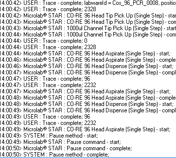

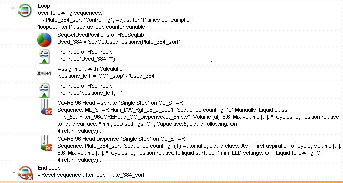

I feel like this probably has an easy fix, but I can not seem to figure it out. I’m looping over a large sequence and after each 96 channel pipetting step is done, I want to get the used position count and then subtract that by the total positions in the sequence to get the remaining number of positions left. The first pipetting step does change the used position count and the remaining positions count, and then it stays the same for the rest of the pipetting steps. If someone could please tell me what I’m doing wrong I would greatly appreciate it!
I realized that the SeqGetUsedPositions only gives the positions used in the last step, so is there an easy way to concatenate the positions from each step?

After reading your last reply and understanding your objective, I can suggest 2 possible solutions:
Solution 1:
Adjust your calculation to
positions_left = positions_left - Used_384
Set positions_left, above the loop in the method, to equal MM1_stop or a variable from SeqGetTotal
Solution 2:
Use a calculation, from variables assigned by Seq functions eg.
SeqGetCurrentPosition assign to variable Current_384
Used_384 = MM1_stop - Current_384
SeqGetCurrentPosition needs to be inside the loop so it’s dynamical calculated. The stop position can calculated once, before the loop in the method, as it remains static
Ahhh yes Solution 1 was what I was looking for, thank you!! I forgot that I needed to keep the original positions_left out of the loop in order for this to work. Thanks again!
