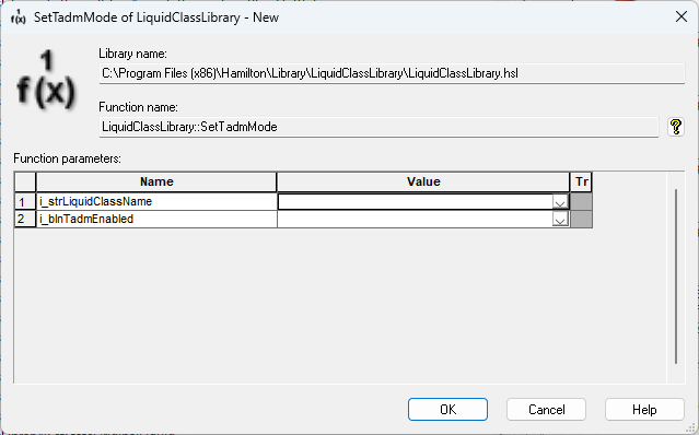

As Nick mentioned earlier, the TADM value for Recording, Monitoring, and Off is read at the beginning of the run during the analysis/connection phase. So even if you programmatically adjusted its value, no changes will be made until the next run.
This being said, you can use the Liquid Class Library to programmatically enable or disable TADM on the liquid class level right before use.
