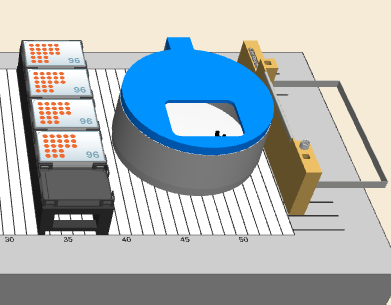

Sorry with the late reply, but I uploaded a labware definition with a 3D model for the Sias centrifuge here. The position will likely need to be re-taught/confirmed prior to performing any transfer steps given that this device is integrated into the deck, but at least it should be in the ballpark.
As Max indicated though, just adding and teaching a plate on the deck also works for device handoff positions.
-Eric
