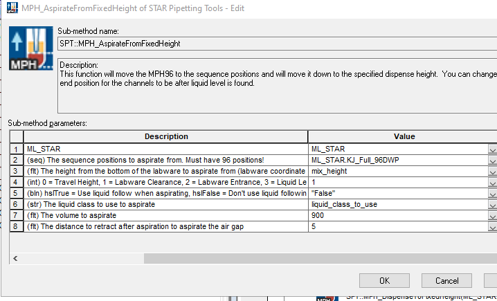

Maybe the PipettingTools library mentioned here would help? Multi-point mixing while keeping the tip in the well the entire time - #2 by NickHealy_Hamilton
Awesome, thanks a lot!

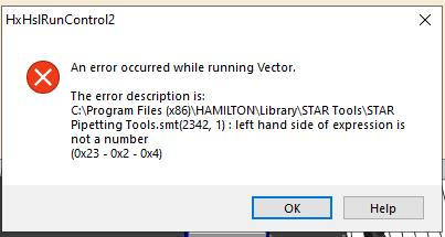

I tried that option, I get the following error:
My parameters:
Thanks a lot!
Hi @KevinJ
Your input string “False” does not compile in VENUS as a boolean, which is resulting in an improperly typed variable that cannot be properly resolved at runtime. “left hand side of expression is not a number” is a catch-all error description for any variable type mismatch, any time a variable value for an assignment, result of an expression, or return value of a function.
VENUS does accept integer values of 0 and 1 for hslFalse and hslTrue, respectively. Otherwise you can add the ASWGlobal library to your method, which defines globally used constants (ASWGLOBAL::BOOL::TRUE and ASWGLOBAL::BOOL::FALSE) that will be available to any method or library which references ASWGlobal. These constants map the the compiler recognized booleans of hslTrue and hslFalse.
Amazing, that works. Thanks Nick.

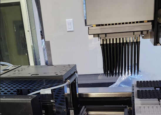

I did some testing and was able to get where I wanted to go, but I was a bit too hasty. During a movement of the head, I thought it was going to collide with something, so I switched off the instrument while the head was moving down.
After restarting it and beginning the initialization process, the head loaded with tips moved to the top-left corner, where I have an MPE module installed. The tips then started colliding with the MPE.
I quickly stopped the system and restarted it. However, no matter what I do, the head keeps moving to that position, even though my waste is located on the opposite side.
Is there a manual function to force tip ejection? I looked through the control panel but couldn’t find anything. When I have issue with my track gripper, I can take the control of it and guide it where I want. Here, I am stuck.
Even if I try to initilize the system, it is asking me if there is a risk of horizontal collision. If I click yes, it aborts and errors. If I click no, the head goes moves towards the MPE and will collide…
Any idea?
Thank a lot!
