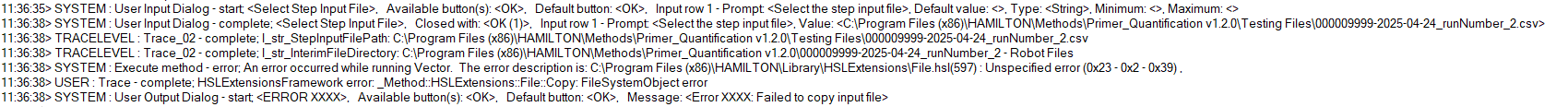

Was there a resolution to the day’s inability to copy files to a local drive location? I am running into an identical issue that I haven’t been able to resolve.

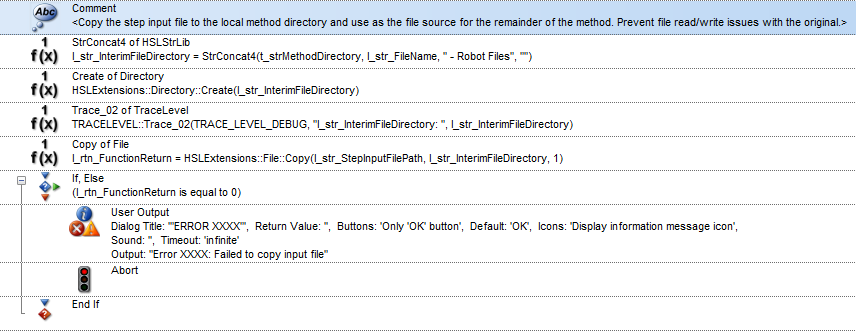

I’m able to create the l_str_InterimFileDirectory folder in t_str_MethodDirectory, but when I go to File:Copy the l_str_StepInputFilePath file to this new directory I get a FileSystemObject error (see logfile image). I am able to copy the file of interest to t_str_MethodDirectory but not into the newly created l_str_InterimFileDirectory folder.

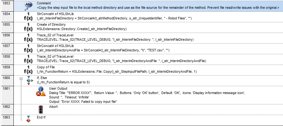

SOLVED!
I tinkered with this some more and discovered the issue and was able to resolve it. The File:Copy command second parameter requires the directory as well as the file name and extension as part of the entire string in order to copy the file with a new name. I was not providing the file name and extension in the above portion of this post.
Here is how I changed my method to make it work. The main change was to concat the directory (l_str_InterFileDirectory) with the file name I wanted the copy to be (l_str_InterdimdirectoryAndFile) on line 1857.
Leaving this edit up in hopes it will help someone else in the future.
