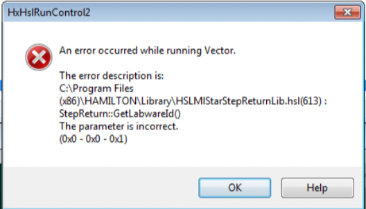

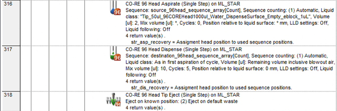

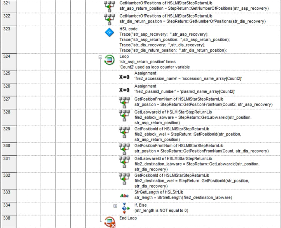

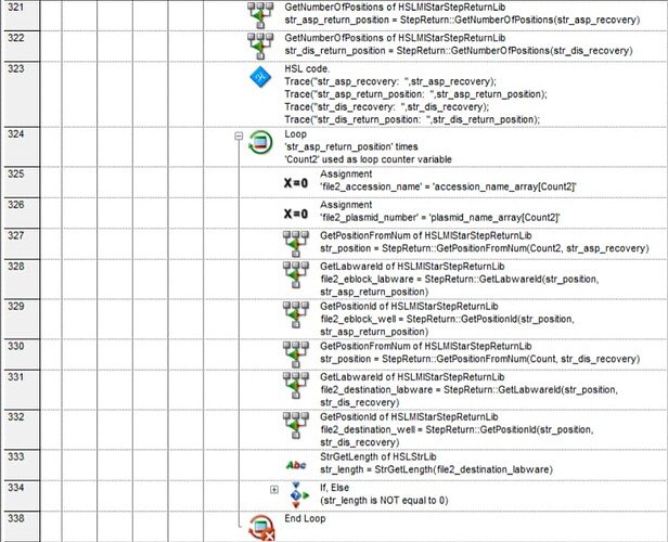

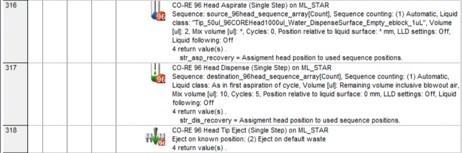

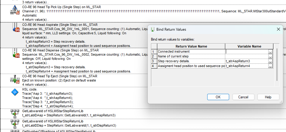

I am trying to use the HSLMlStarStepReturnLib to get the labware and position IDs from the 96 MPH. I have successful experience doing so with the span-8 in the past, so I tried replicating for the 96 MPH but to no avail. Below are snippets of my protocol in question:
Running in simulation, this is the error that I get which is self-explanatory:
2025-03-26 11:33:30> USER : Trace - complete; str_asp_recovery:  [07,A1[08,B1[15,A2[16,B2[23,A3[24,B3[31,A4[32,B4[39,A5[40,B5[47,A6[48,B6[55,A7[56,B7[63,A8[64,B8[71,A9[72,B9[79,A10[80,B10[87,A11[88,B11[95,A12[96,B12
2025-03-26 11:33:30> USER : Trace - complete; str_asp_return_position:  24
2025-03-26 11:33:30> USER : Trace - complete; str_dis_recovery:  [07,A1[08,B1[15,A2[16,B2[23,A3[24,B3[31,A4[32,B4[39,A5[40,B5[47,A6[48,B6[55,A7[56,B7[63,A8[64,B8[71,A9[72,B9[79,A10[80,B10[87,A11[88,B11[95,A12[96,B12
2025-03-26 11:33:30> USER : Trace - complete; str_dis_return_position:  24
2025-03-26 11:33:31> SYSTEM : Execute method - error; An error occurred while running Vector.  The error description is: C:\Program Files (x86)\HAMILTON\Library\HSLMlStarStepReturnLib.hsl(613) : StepReturn::GetLabwareId() The parameter is incorrect. (0x0 - 0x0 - 0x1) ,
2025-03-26 11:33:31> SYSTEM : Method has been aborted by the system - complete;
2025-03-26 11:33:31> SYSTEM : Abort method - start;
Mind you, this setup works for my span-8 pipetting step; therefore, I’m guessing that using the step return functions for the 96 MPH is slightly different than the span-8, but I cannot wrap my head (pun not intended lol) around it.
Any thoughts?

Hi @Nat ,

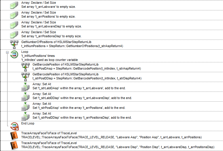

You are right, the MPH does handle the returns slightly differently than the channels. You actually need to use a combination of the 3rd and 4th step return values to get both the Labware and the Position info.
2025-03-26 13:57:45.573 USER : Trace - complete; Asp 3:  0[01,00,00,0,100.0,Cos_96_DW_1mL_0001,
2025-03-26 13:57:45.573 USER : Trace - complete; Asp 4:  [01,A1[02,B1[03,C1[04,D1[05,E1[06,F1[07,G1[08,H1[09,A2[10,B2[11,C2[12,D2[13,E2[14,F2[15,G2[16,H2[17,A3[18,B3[19,C3[20,D3[21,E3[22,F3[23,G3[24,H3[25,A4[26,B4[27,C4[28,D4[29,E4[30,F4[31,G4[32,H4[33,A5[34,B5[35,C5[36,D5[37,E5[38,F5[39,G5[40,H5[41,A6[42,B6[43,C6[44,D6[45,E6[46,F6[47,G6[48,H6[49,A7[50,B7[51,C7[52,D7[53,E7[54,F7[55,G7[56,H7[57,A8[58,B8[59,C8[60,D8[61,E8[62,F8[63,G8[64,H8[65,A9[66,B9[67,C9[68,D9[69,E9[70,F9[71,G9[72,H9[73,A10[74,B10[75,C10[76,D10[77,E10[78,F10[79,G10[80,H10[81,A11[82,B11[83,C11[84,D11[85,E11[86,F11[87,G11[88,H11[89,A12[90,B12[91,C12[92,D12[93,E12[94,F12[95,G12[96,H12
2025-03-26 13:57:45.574 USER : Trace - complete; Disp 3:  0[01,00,00,0,100.0,Cos_96_DW_1mL_0002,
2025-03-26 13:57:45.574 USER : Trace - complete; Disp 4:  [01,A1[02,B1[03,C1[04,D1[05,E1[06,F1[07,G1[08,H1[09,A2[10,B2[11,C2[12,D2[13,E2[14,F2[15,G2[16,H2[17,A3[18,B3[19,C3[20,D3[21,E3[22,F3[23,G3[24,H3[25,A4[26,B4[27,C4[28,D4[29,E4[30,F4[31,G4[32,H4[33,A5[34,B5[35,C5[36,D5[37,E5[38,F5[39,G5[40,H5[41,A6[42,B6[43,C6[44,D6[45,E6[46,F6[47,G6[48,H6[49,A7[50,B7[51,C7[52,D7[53,E7[54,F7[55,G7[56,H7[57,A8[58,B8[59,C8[60,D8[61,E8[62,F8[63,G8[64,H8[65,A9[66,B9[67,C9[68,D9[69,E9[70,F9[71,G9[72,H9[73,A10[74,B10[75,C10[76,D10[77,E10[78,F10[79,G10[80,H10[81,A11[82,B11[83,C11[84,D11[85,E11[86,F11[87,G11[88,H11[89,A12[90,B12[91,C12[92,D12[93,E12[94,F12[95,G12[96,H12
Step return 3 will return you the labware id, volume, and any error/recovery information that was used, where step return 4 will give you the channel and well. Note that the values within step return 3 do not require a loop as there will be a single return for it. This is because the MPH will only access one labware, use one volume, and will only show one error for the whole MPH.
To get the wells, you have to use a different function than what you would expect. This is because it returns the values as two items per position. So, you need to use a step return function that gives you the second indexed item per position. GetBarcodePosition will return this for you:
2025-03-26 13:57:47.509 TRACELEVEL : TraceArraysFaceToFace - start;    -------------------------------------------------------------
