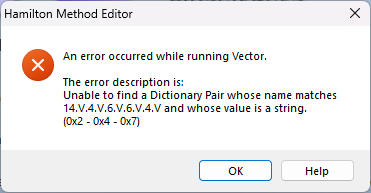

Last week we encountered this error (below) on our PC running Venus 4. To fix it we did a Venus “repair”. The issue went away for a week only to appear again and cause a run crash. The trace was completely cut off and Run Control was killed.
Has anyone had this issue before? I have not seen this error “Unable to find a Dictionary Pair whose name matches…” before.

Your installation’s primary instrument configuration file is getting overwritten or otherwise being modified/corrupted in a manner that is altering required VENUS version-specific data within the file, affecting one or more instrument steps being used during runs of the affected method.
A software repair was effective as it restores all installation version-specific default files to their original state. The ML_STAR(let).cfg which maintains the affected dataset in your case is one of these files.

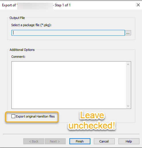

The most common way this type of issue is introduced is if during pkg export/import, the toggle for ‘include default Hamilton files’ is selected when importing a pkg prepared in a different version of VENUS. It is strongly recommended to not use this toggle, and leave it unchecked.
If your instrument configuration file was overwritten, it is possible other version specific files could have been affected during whichever event caused the original file modification. I would run another VENUS repair.

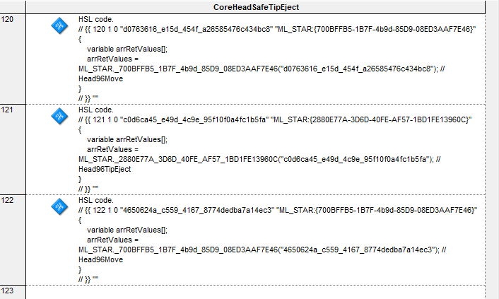

No problem. I have uploaded the files. I also am attaching an image here of what some liquid handling (aspirate/dispense → raw hsl) steps look like in .med on this “corrupted” computer incase it contains clues into whats going wrong.

If method editor isn’t capable of rendering default ML_STAR instrument commands (which can be opened and edited in their respective UIs) and is resorting to displaying the original autogenerated HSL maintained in the .hsl or .hsi file, then this installation is either incomplete or corrupted. Key Windows registry entries which maintain instrument step software data required by VENUS is either missing from initial install or somehow being deleted.
For the ‘Unable to find a dictionary pair…’ error when opening method editor for the affected method also indicates corruption for ML_STAR steps programmed within the method. It looks like somehow lower level step metadata in one or more of the dependent files is also getting removed or otherwise tampered with.

I wanted to note here that the latest version of the VENUS Programming Practices (v5) pdf in section 5.2 (pg 25) explicitly recommends that you include the original Hamilton files upon export. If there are plans to update the VENUS Programming Practices guide, can this additional bit of guidance be added, so others don’t make this same mistake?

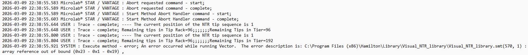

Fresh install worked, installed all the packages. All seems to work with exception for the Visual_NTRv1.46. Have anyone seen this before?
Did you run the installer or import a pkg of the submethod library?
Could you please provide the full trace file? You can upload it here. Password is: Hamilton2025

I figured it out. I had forgotten that I had disabled the initial editing of the tip counter so at the end of my script, it was trying to edit a variable that didn’t exist. Everything works after a fresh install.
