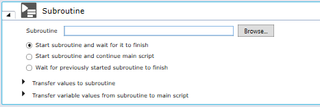

use this command to trigger execution of another script (sub routine)
you can assign variables as needed (IN & OUT) to update parameters as needed
