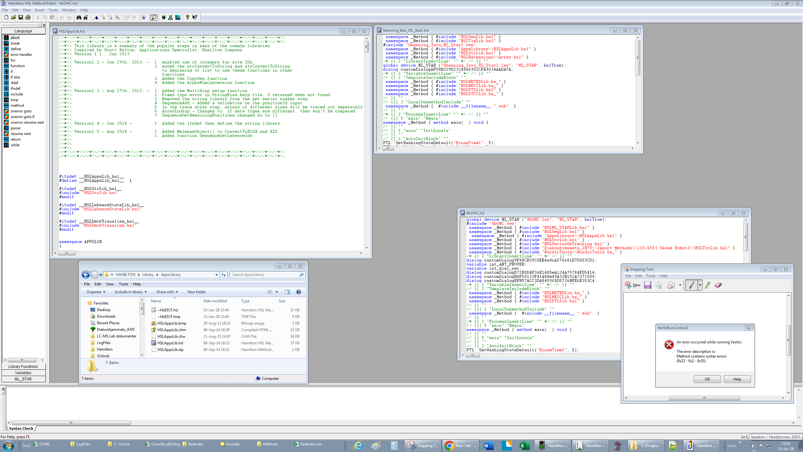

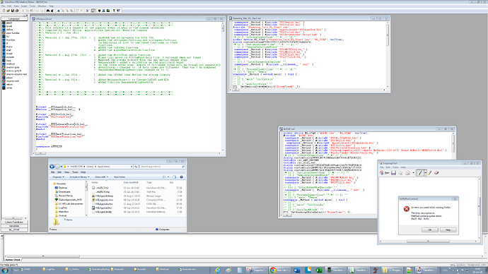

See this screenshot for more information:
up left: HSLAppsLib
down left: location/file path of HSLAppsLib
up right: old method with HSLAppsLib working fine
down right: new method with HSLAppsLib throws syntax error (0x23 - 0x2 - 0x35) → removing the library fixes the problem, but I think I need it → checking the hsl-code for syntax errors shows 0 errors
Has anyone ran into something similar?
I see the extra whitespace btw, but removing it does not change the situation.

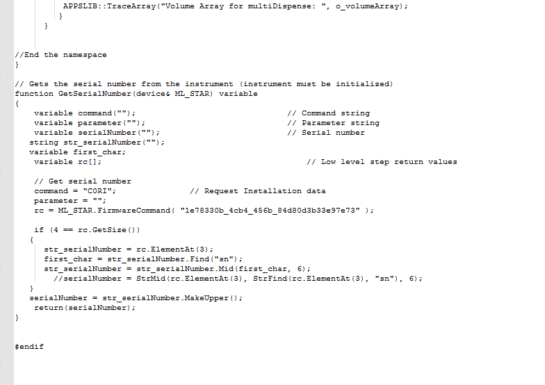

2026-01-15 15:37:08> SYSTEM : Analyze method - progress; C:\Program Files (x86)\HAMILTON\Library\AppsLibrary\HSLAppsLib.hsl(881) : error 1303: identifier ‘GetSerialNumber’ has already been defined

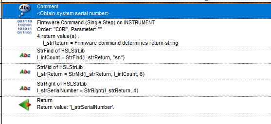

Since I just want to get the barcode I found another approach which might be usefull for other users out there in the future:

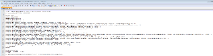

This is the information we’re looking for, as it tells us that the function having an issue is GetSerialNumber, which is being defined in more than one location. Based on what I’m seeing in the HSL file images, it’s likely the NordicTools library, which is the only one I am unfamiliar with. Can you share a screenshot of the library references in “NordicTools.hs_”?
Also, looking at the HSLAppsLib, the GetSerialNumber function exists outside the APPSLIB namespace, so it’s possible that another library has a function with the same name (also likely outside a namespace) which would interfere.

If the ‘GetSerialNumber’ function were wrapped into this namespace, then when it gets analyzed at runtime, it would be seen as ‘APPSLIB::GetSerialNumber’. Since the library does not include it in the APPSLIB namespace, the analyzer sees it as ‘GetSerialNumber’. This means another library exists that is being referenced by a this method in which the ‘GetSerialNumber’ function lives outside any namespace, so it gets analyzed as ‘GetSerialNumber’, causing the error.

Your solution is quite good, the VectorDbTracking library has loads of functionalities for barcoding (you can also look up labwares by their barcodes with it). If you are only interested in the barcode of a labware (or container) within a known sequence, you could also use GetLabwareBarcode from the LabwareState library, which is a default Venus library.

Here is the screenshot:
GetSerialNumber from HSLAppsLib:
Hi @yunghans,
These screenshots confirm that the GetSerialNumber function in the HSLAppsLib does exist outside the APPSLIB namespace, however, they don’t confirm that another copy of the function exists in NordicTools (though it could still exist either in the .hsl or .hsi files or futher into the .hs_ file). You could make modifications to either library by moving the GetSerialNumber function into the main namespace, putting it into its own namespace, or deleting the function, but any of these options would cause issues in which the libraries are currently added and the GetSerialNumber function is being used. It also risks potential library version overwriting in the future with method import/exports. As such, the recommended course of action would be to avoid using NordicTools and AppsLib in the same method or its dependencies.
