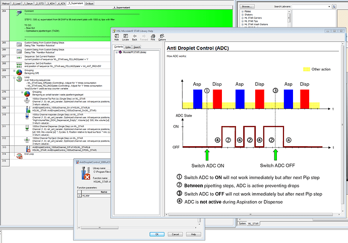

Is this the right use of Anti-Droplet-Control (ADC), and will this NOT interfere with TADM?:
Hi @yunghans ,
In your example, I would recommend turning on ADC after the aspirate since the tip will be fresh at the time of the first aspiration. There will be no necessity for monitoring at that time.
No ADC should not affect TADM. ADC monitoring is turned off during aspiration and dispense steps.
Thank you for the quick reply!
I don’t fully understand why I should turn on ADC After aspiration.
The figure shows that if I turn on ADC before aspiration it will prevent Drops between aspiration and dispense - which I want.
And turning it off After dispense will Turn it off After tip eject (?).
But if I understand the figure Right turning on ADC Afters Aspiration will only prevent Drops After dispense and tip eject to waste - or did I misundersrands?
Isn’t tip eject «other action»?
Appreciate and Looking fortward to your reasoning!
Greetings from Oslo!

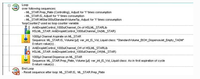

Hi @yunghans ,
Apologies. I had to consult the sacred texts for clarification. How the enabling and disabling works is it sets a background parameter to either off or on. This inherently doesn’t change the monitoring mode at the time the command is called but will turn it on/off on the next Aspiration/Dispense step only.
So, the order of operation would be to turn it on before your first aspiration like you have and then you turn it off BEFORE the last action you want to monitor for drops. Typically, this would be the dispense. Below is an example:
Even though the off command is called before the dispense, it won’t actually stop monitoring until after the dispense has finished.
Setting it up in this way makes sure that ADC does not carry over to the next pipetting loop when it isn’t expected.
