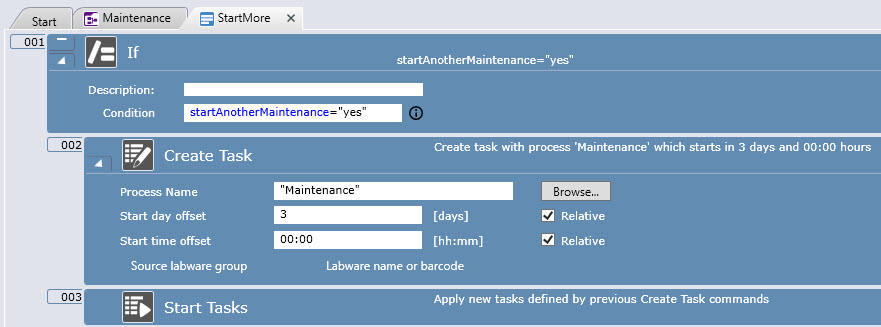

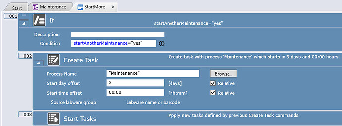

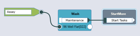

Two or more processes can be scheduled in parallel if they both have the same Base Worktable selected at the Worktable dropdown (below Process name)
To define start times and launch processes in a more flexible way at a specified date & time, I suggest to look into the Task functionality where one can add processes either by script commands Create Task & Start Tasks or by adding a *.twl task input file to the C:\ProgramData\Tecan\VisionX\Worklists folder. See FluentControl Manual chapters called ‘Support for Cell-based Assays‘ & ‘Task Input File‘
For example a ‘Maintenance’ process that at the end will create a task to start again a fresh Maintenance process in 3 days.
