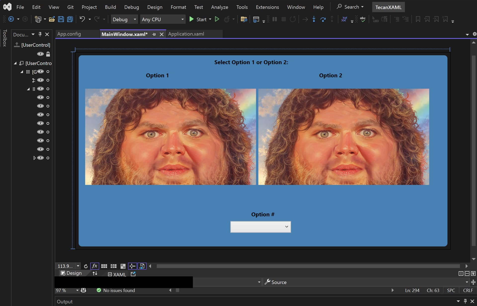

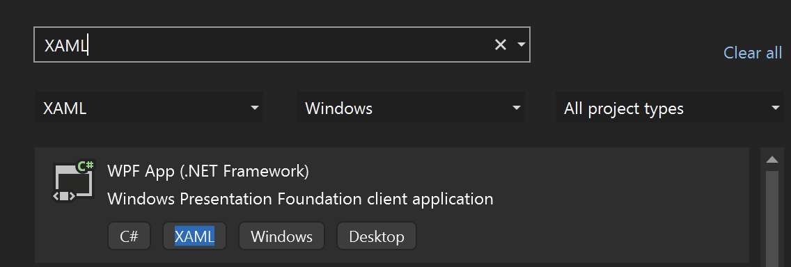

Also you can mock your Custom TouchTools XAML’s in Visual Studio 22 (and maybe even Rider but haven’t tried that yet.)
Here’s a real UI that works on the Tecan Fluent with a dropdown that passes the variables to Fluent Control.
Here’s the template you need to start your mocks.
Final step is to reference the .DLL’s from the Tecan folders that will populate the custom dialog boxes and other features.

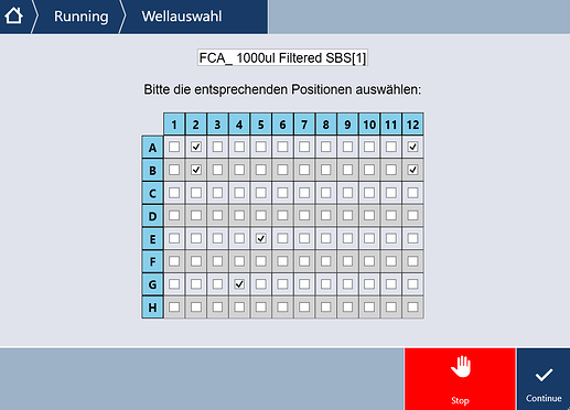

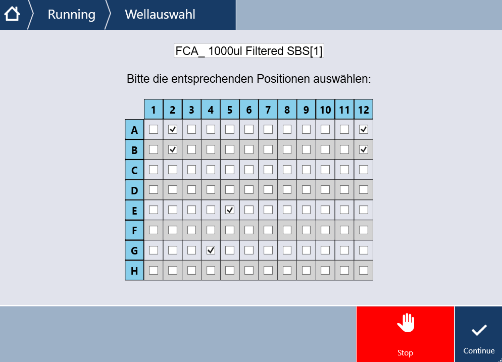

Thanks to all of your comments and shared examples, I was able to understand the XAML syntax and was able to create a first touch panel dialog to select wells/positions and e. g. manipulate DiTi positions during runtime.
To show the name of related labware I managed to display it as a non editable TextBox. Seems that supported XAML elements are limited.

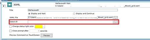

First wish is to have a way to select multiple checkboxes with a kind of master checkbox. I’ve experimented a bit but did not get far. I guess I would need a DLL which is selected together with the XAML file to provide the necessary code. But how to set this up? Can’t find any documentation about that…
I considered the hint to VisualStudio. But as I have no eperience there and even did not get the SW myself this becomes more complicated. - A colleague of mine offered to help out with his VS installation, but he’s not familiar with this specific topic.
Is there any chance someone could share some more insights to point us in the right direction? That would be really nice and helpful!
