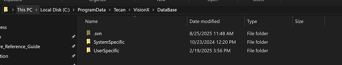

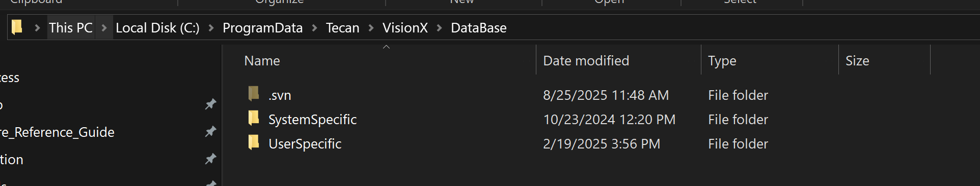

I do see the .svn:
C:\ProgramData\Tecan\VisionX\DataBase.svn
but no “SVN folder”:
It looks like the actual scripts/method live in:
C:\ProgramData\Tecan\VisionX\DataBase\UserSpecific
Is it as easy for us just to gitnore the .svn and just track the UserSpecific folder?
The SVN folder is C:\ProgramData\Tecan\SVNRoot\SystemSW_1.0
