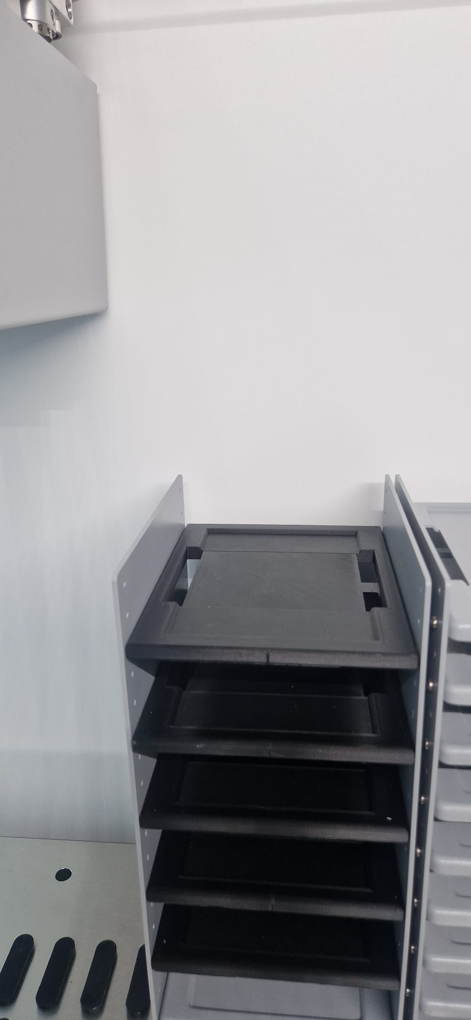

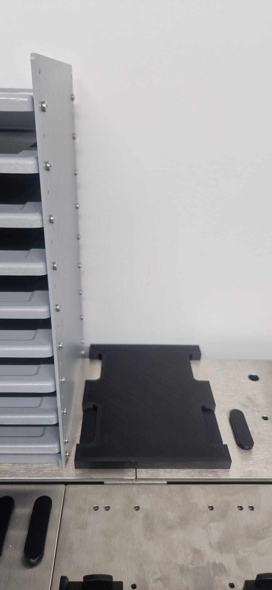

Hello every one,
I wanted to give a bit of my contribution:
I created the Tecan Fluent Hotel in 3D so you can add new hotels to your table.
It works very well. I sadely could not test the walls because my printer is too small so if you have something big enough keep me updated !
Cheers !
