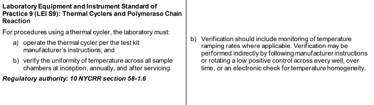

That said, New York State requirements states that each cavity of a thermocycler must be tested at certain intervals:
To meet that requirement, one would need to move on to something like the TAS System with additional probes

OVT satisfies option A.
We never had issues with NY using the OVT.
With that said audits are tricky and opinions can differ from auditor to auditor but technically the OVT is the manufacturers test kit.
Inheco may also have additional information about the OVT and how that satisfies their internal or external requirements (think of Quality docs for consumables that are sterile) and it would be nice to file those as an insurance policy.

Thanks for your reply. Your interpretation is our interpretation and testing plan as well for the ODTCs, so I am glad that other have come to the same understanding and plan as us!
