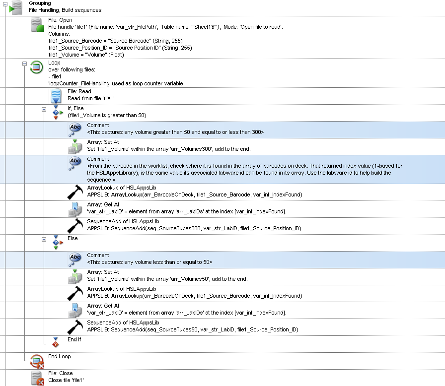

In the VENUS challenges on arrays and barcoding, exercise 4 provides an example of how this can be accomplished. When you add to the array of volumes, you can add to the sequence (labware id and position id). That way the volume that corresponds to the proper position id are in the same order. You can have an If statement to determine if the volume is greater than 50uL, then it adds to the array of volumes and sequence position for 300uL tip transfers. If under, then it would add it for 50uL tips.
See below for an excerpt - please note that this example also incorporates barcode handling so there is a step to confirm and get the labware id associated with barcode.

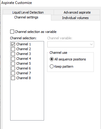

So I had this issue. Since this only happens at a step using max 8 samples, i choose a really inefficient solution as it can be slow since its just 8 samples. I have the volumes in an array, and basically loop through the samples, and just use one channel at a time. Each loop, i draw in the volume from the array, and use an if else for the volume - uses 50ul tips if <50, 300ul tips if > 50. A bit of a hacky approach, but it worked for a method i had to put together quickly

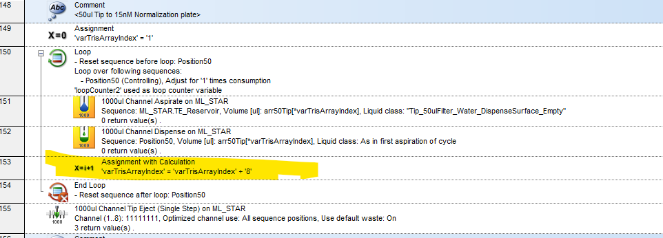

Your “volume” should be the actual array, no need to pull it out and use a variable. You are missing the advancement of the array index which will fix your issue. See line 153.

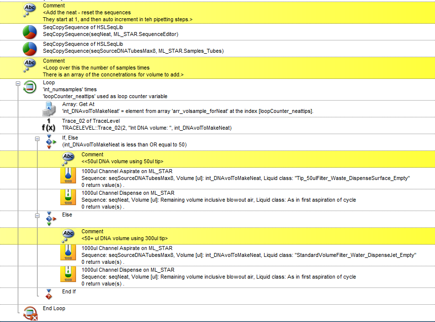

I have a normalization script that runs the same way, this is how I did it.
The incrementing is working, as im’ only using 1 channel, and looping over my samples

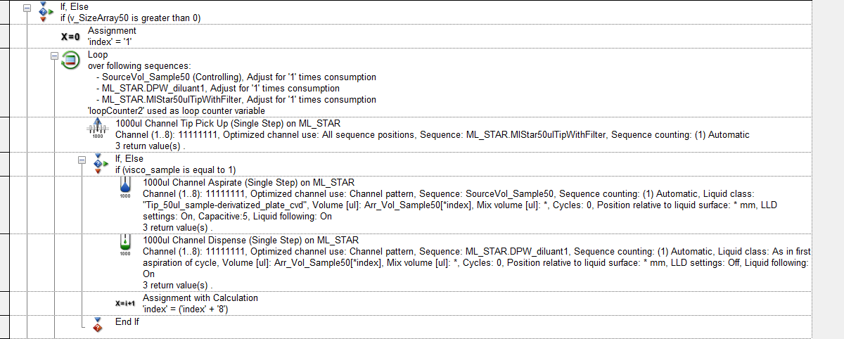

Thank you for your help. I have added my method and the Excel file I use for this sequence. Their names are: 260218_amino_acids.pkg and the Excel file is :Template_amino_acid. Actually, I don’t understand how to retrieve the initial volume indexes so that I can put them back in order when dispensing. I saw that you use scans in the exercises, but this gets mixed up with the index blocks. Thank you in advance for your help.
Hey Darren, does my comment above answer that? You use the array as the volume. For example, Array50ulTips is paired with the Position sequence that you generated.

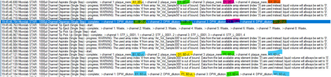

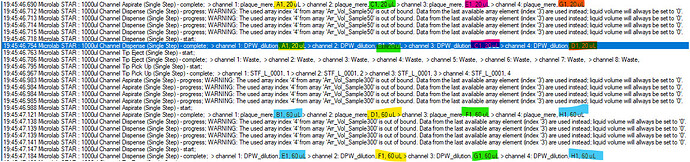

Hello, thank you for your reply. I use this for my sorted arrays. However, as we can see, well C1 of the plate is not dispensed into well C1 of the DPW but into B1.
(it’s same for 300µL tips) and I have this result :

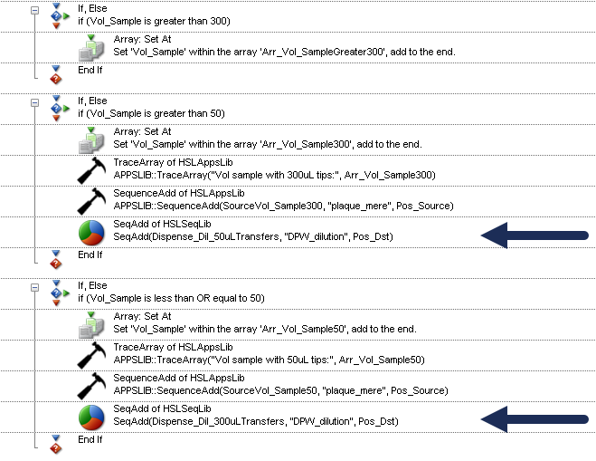

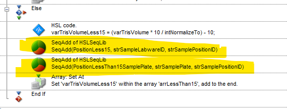

@Darren Your dispense sequence should have a sequence created during the “Sequence Add” (back when the script was reading through the file). This means depending on where you’re pipetting from (for example, another 96 well plate) you will have 2 Seq Add statements:
Additionally what’s actually happening here is that your loop is progressing DPW_dilutant_1 from A1 to B1, not the sequence. Unclick the DPW_dilutant_1 from the loop.
In your method, it appears that you’re using one sequence “DPW_diluant1” for all the dispense steps. My recommendation would be to build a sequence for the transfers using 50uL tips, and a sequence for the transfers using 300uL tips when you are building the arrays.
Then in the actual transfer steps, you would select the specific sequence.
