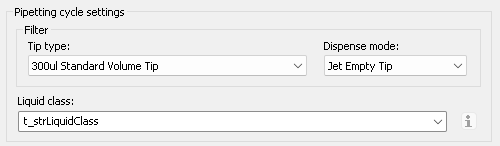

I very often get asked to change and test different tips for the same protocol and it’s a very painful process to change tip types at all aspiration and dispense steps. Is there any way to make tips a variable so I can change it whenever I want?

The Tip type and Dispense Mode drop downs are just filters to make it easier to select a Liquid Class.
You can use a variable for the liquid class so it could be any tip type - this overrides whatever is set in the Tip Type and Dispense Mode drop downs. Just be sure the tip sequence, which can also be a variable, matches the liquid class.

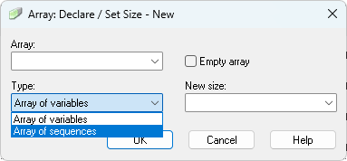

You can also make an array of sequences and when you get from the array, it’s assigned to a variable. Or you can put the array directly in the input sequence field and select the index for the sequence you need.
