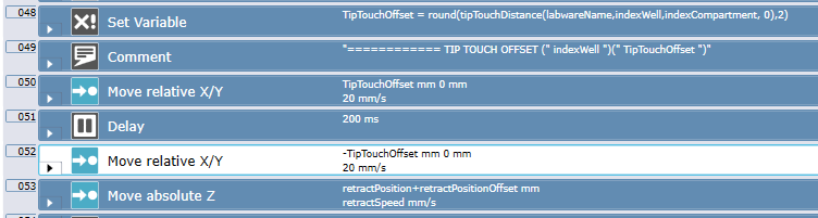

after the tips have moved to the dispense position, you add the command to call the tipTouchDistance and save to a new variable
i would also add a round() function to NOT get 14 decimal places …
after the dispense step, then add a “Move relative X/Y” command to actual perform the move
add a delay
then reverse the X/Y move
capture below

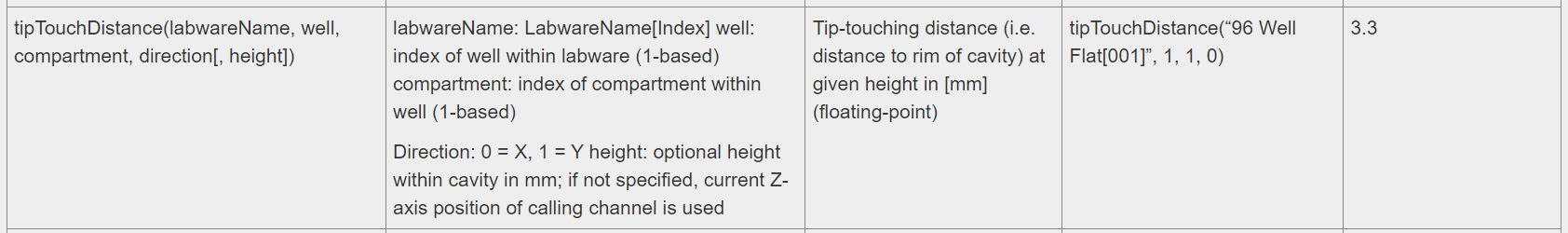

Below is the syntax for the tipTouchDistance() function, found in the integrated Help guide:
It is important to note that this function has you provide the height in the well, as it will reference the compartment definition defined in the labware. Imagine you are in a PCR plate - the tip touch distance will vary greatly depending on the location of the tip in the well.

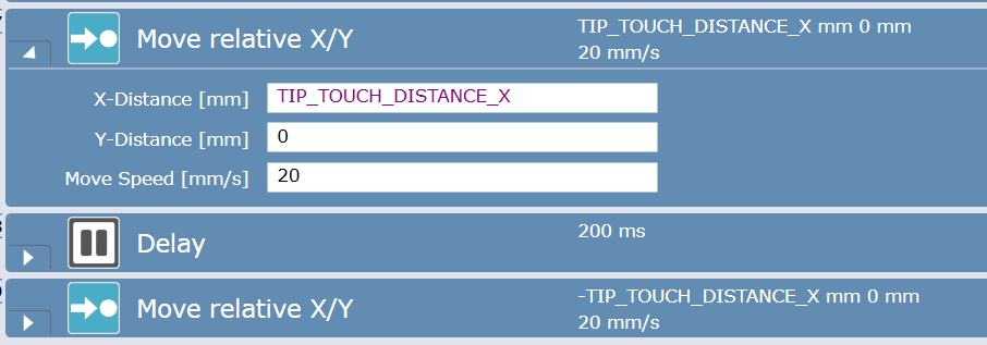

Instead of using the function, you can simply use the pre-defined variables TIP_TOUCH_DISTANCE_X and TIP_TOUCH_DISTANCE_Y. These automatically calculate the tip touch distance based on the current height of the tip in the labware.
the example I gave will work for any labware & well referencing this liquid class
tipTouchDistance(labwareName, indexWell, IndexCompartment, 0),2)
the last 0 is the direction of movement (X=0, Y=1)
the 2 is actually part of the “round” function I called,
my tipTouchDistance command yielded a result of 4.07470153381327
i added the round to 2 dp as I felt 14 dp was a little excessive !!
which then reported 4.07
