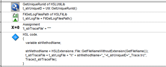

Using some default libraries as well as the HSL Extensions: File library you can easily put the trace file path together:
   variable strMethodName;
   strMethodName = HSLExtensions::File::GetFileNameWithoutExtension(GetFileName());
   t_strTraceFile = t_strLogFile + "\\" + strMethodName+"_"+t_strUniqueID+"_Trace.trc";
   Trace(t_strTraceFile);
This will dynamically update as you change the name of the file.
