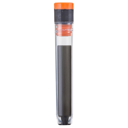

It looks like one can draw the geometry of a single tube quite easily from the manufacturers part website (or at least something very close to it):
But would you really 3D-print the tube and the cap?
Spending this much money on a tube I’d assume you have some important cells to store.
How would you sterilise a 3D-printed tube (I have only found one FDM 3D-printable material, after 8 years of occasional searching, that can be autoclaved; do you know of an SLA-printable material that can be autoclaved)?
I have not used the Azenta tri-coded tubes, though I really like the tri-coded part, but can you intermittently use Thermo Fisher Scientific’s alternative Matrix tubes until Azenta gets their production in order?
