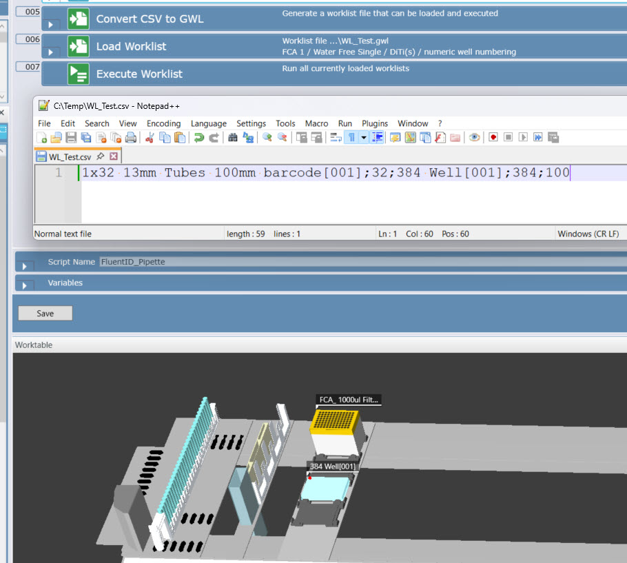

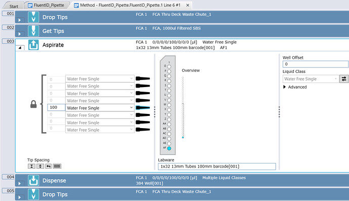

With FluentControl version 3.8 SP1 when I program a short worklist with just that one single last pipetting step to aspirate from tube 32, it generates a pipetting script that uses tip 5.

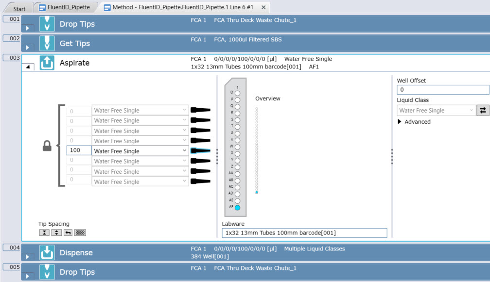

When trying to program the same step with normal Aspirate command and try using tip 4, it gives a red marked line with an “…out of range…“ error message.
Generally worklists shall consider the arm range and make tip to well assignments that are physically possible. Probably it’s a indeed bug in FC 3.0 that is fixed in later versions.
Worklist with one aspirate from tube 32:
Automatic generated pipetting script is using tip 5:
