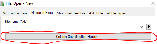

But we have made a generic code snippet of what the python script does (see below). The xls output file is not recognized/parsed, when using the Column Specification Helper in the “File Open - New” step:

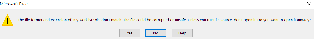

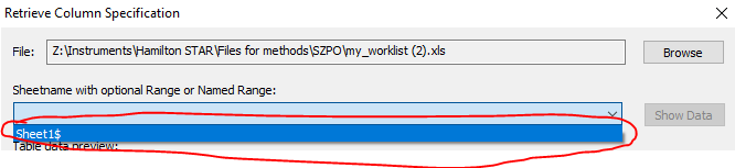

But after opening and closing the output file in Excel, the file format is recognized/parsed:

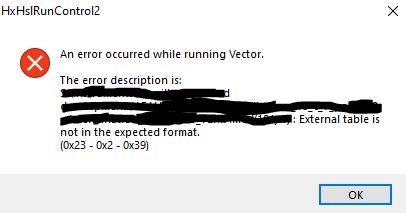

Exchanging xlwt with openpyxl gave rise to the following error when opening the Excel file (see code snippet below):
