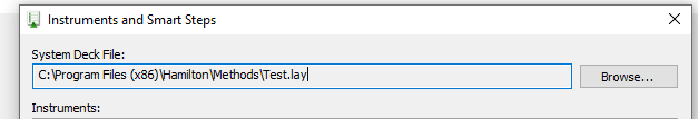

It shouldn’t require much work to add the ODTC to the original Deck Layout(s) associated with your Methods. However, if you want to create a new Deck Layout with the ODTC that is separate from your original Deck Layout, then you can use the instructions below:
  1. Open your Method in Method Editor
  2. Go to the “Method” menu across the top of the window, and select “Instruments and Smart Steps…” from the drop-down.
  1. In the window that pops up, you’ll see the Deck Layout that is currently associated with the Method
  1. You can change the Deck Layout by clicking the “Browse…” button, opening the new Deck Layout you want to use, then clicking “OK” to close the window. The new Deck Layout should open in Method Editor. At this point, return to your Method and Save so that the new Deck Layout association holds.
Let me know if you have any questions.
