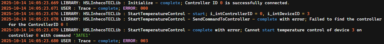

Second issue that I am running into is the CPAC Inheco Library. It’s successfully connecting to the controller, however fails to set and start temperature.
@DanHartman_Hamilton @EricSindelar_Hamilton
is there a newer library for the Inheco CPAC?
