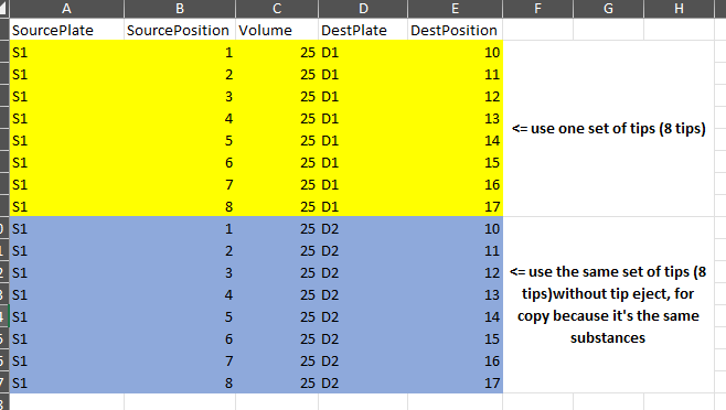

From time to time I have some copies to dispence and I don’t realy like to use new set of tips. So, I was wondering is there a way to use the same 8 tips ONLY for copy..
I also have screenshot, might help
I see it like this. Tip pick up, aspirate, dispense then again aspirate, dispense to the copy and tip eject.
I hope you understand my idea. Thanks for any help!
Hi Oleksandr,
yes, that can easily be done if you do manual sequence counting for the source position and count up only when all dispenses are fulfilled.
There are many possible ways to do this, either hardcoding or going from a worklist and change tips only if the source position changes, for example.
