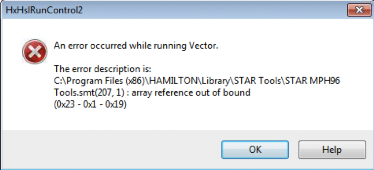

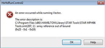

For context, I am using the STAR MPH96 Tool library multiple times to pick up tips offset in one of my method. My method is divided into two protocols (protocol #1 and protocol #2), and each protocol is using the same library except with different tip and labware sequences. When I run each protocol individually (i.e. protocol #1 is enabled but protocol #2 is disabled), the library works perfectly. However, an error occurs when I run both of them together (i.e. protocol #1 and #2 are enabled).
When running both protocols together, protocol #1 runs smoothly and then protocol #2 starts to run smoothly before this error occurs when it comes to the last set of tips. Interestingly, when I flip the protocols in the order of run (i.e. protocol #2 runs first and protocol #1 runs second), the same behavior and error occurs. I tried multiple trouble-shootings, including moving my arrays around, but I am running out of ideas.

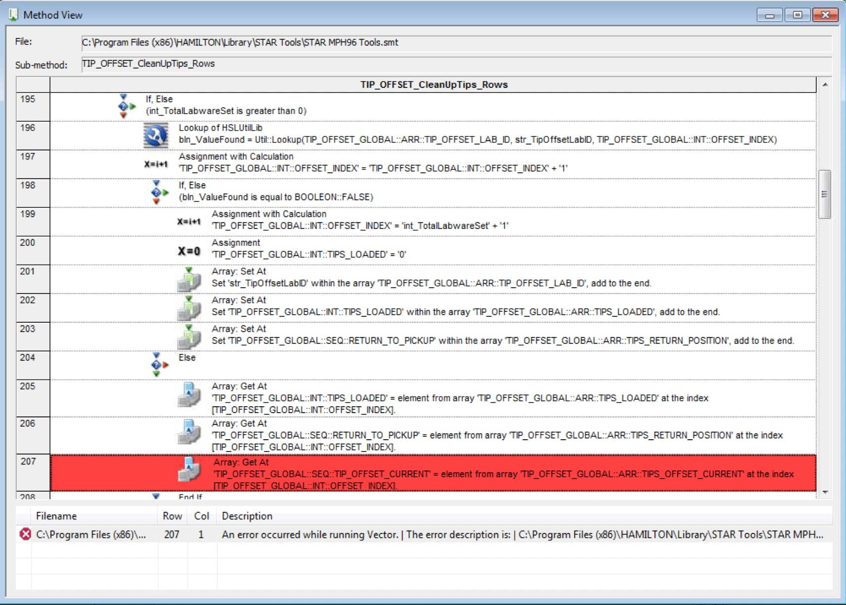

I can’t give you a complete answer but you can open up the library and go to the line of error specified to try and understand why the array referenced is out of bounds. That should help you troubleshoot.
From there you can have different options to make sure you are targeting an existing sequence.

I strongly suspect its a variable scope issue for a sequence object you are iterating over. Somehow you are reusing the same sequence variable across methods/ protocols. This could be an issue inside the .smt method as well, as I believe submethods within an smt all share the same variable scope. If anyone knows better correct me if I’m wrong, but that is what I inferred from the line numbering incrementing across submethods within an smt.

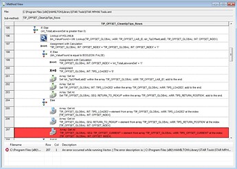

Both protocols have different sequences (tip support, tips, and source/destination sequences), tip counter string, and variables for calculating number of rows for offset. I will note that I am using the same labwares in both protocols but have created different sequences respectively. Further looking into the problem, the error is occurring within the CleanUpTips submethod of the library. When I disabled the CleanUpTips function, both protocols ran smoothly. Of course, it is a necessity for using this function for my method. Any thoughts on this?
I recommend tracing your array of sequences and index before you get to that function and see what values you get. For me the most common mistake I do is inputting a wrong index value, or reference an array value that is not there.
