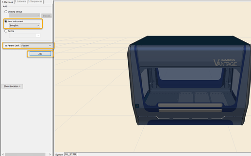

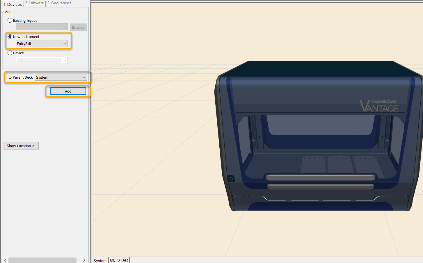

In order to be given access to EE device steps in method editor, you must add it as a device to the ‘System’ section of your deck layout. Having the labware definition of the EE top chutes on the deck layout is helpful to correctly locate the labware used by the corresponding EE stacks, but that alone will not inform method editor or run control that an EE device is present on the system for the method or workflow.

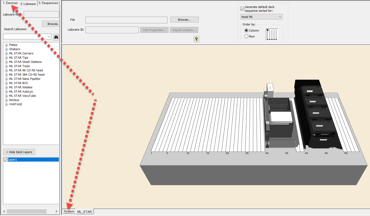

While viewing the deck layout in method editor, toggle to the ‘Devices’ section of the toolbox, and the ‘System’ section of the deck viewer:
Add an EntryExit device from the ‘New Instrument’ list, to the parent system:

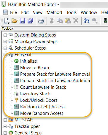

Once added, any method which includes/uses the corresponding deck layout will then have EE steps available in the library/device function toolbox:

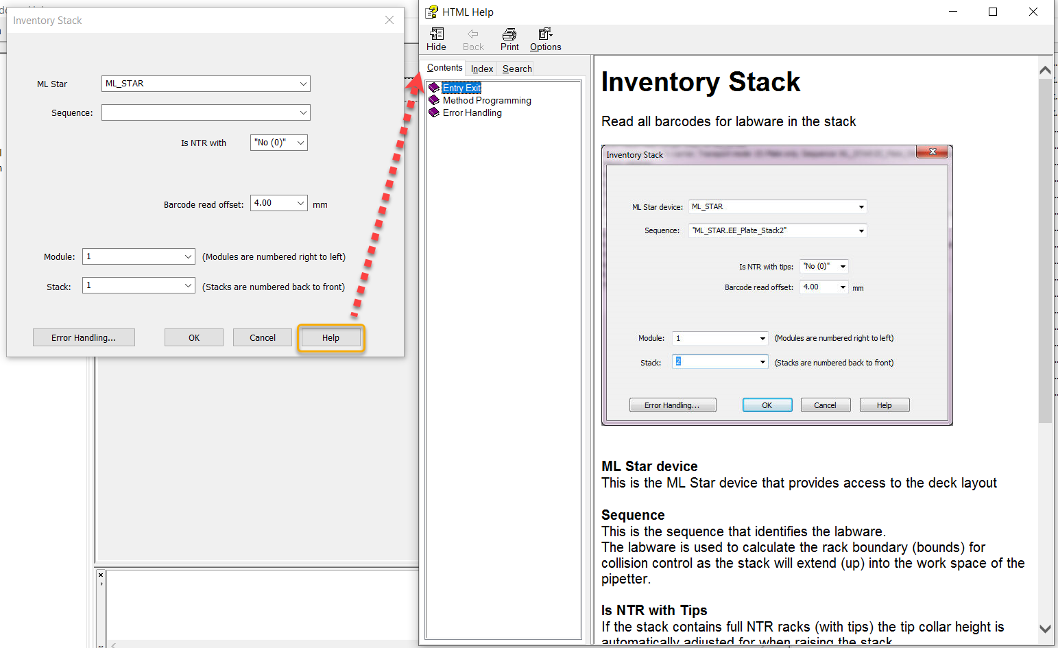

If you open any EE step and select ‘Help’, the EE step documentation file will open, providing details for all of the parameters for each step and how they are used:

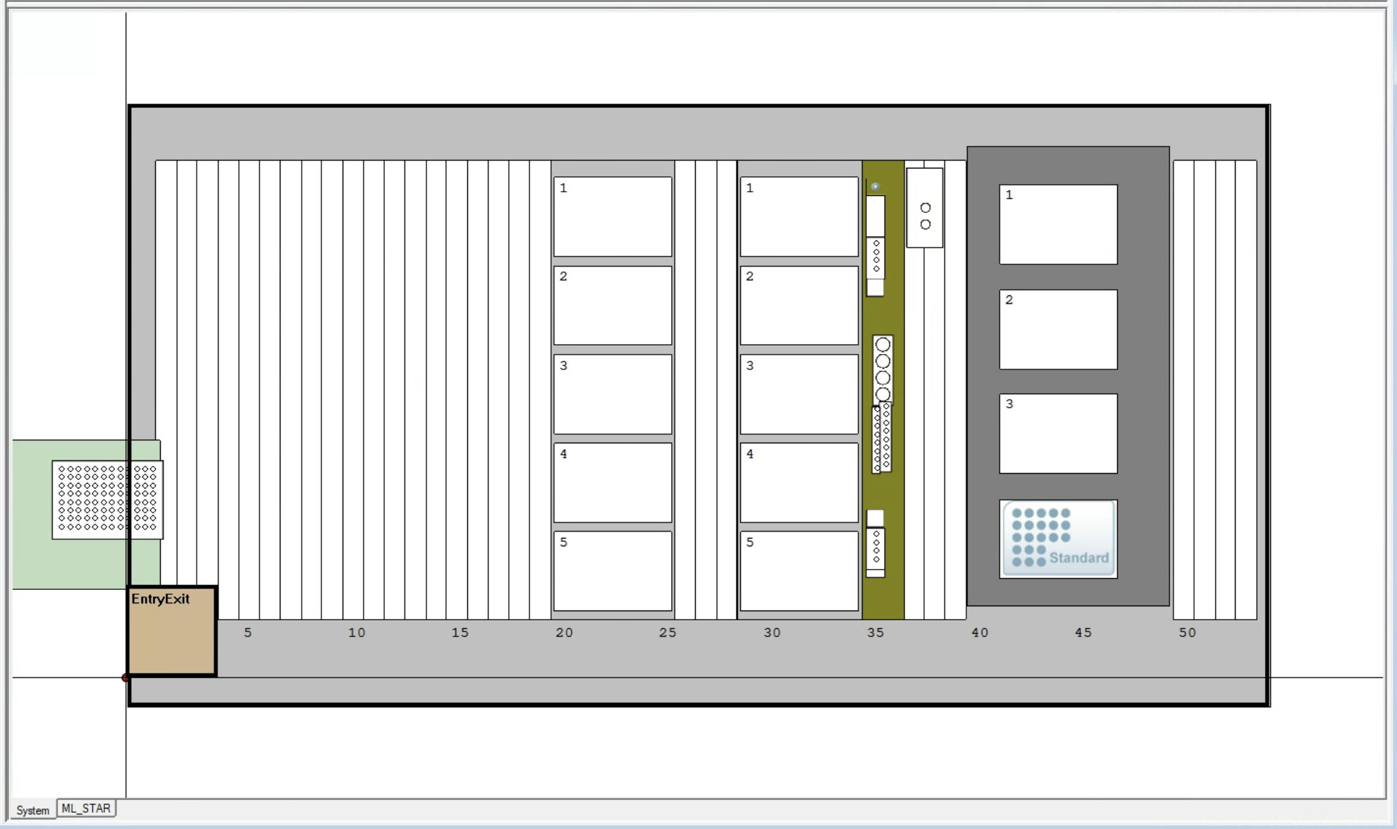

Thanks for the thorough reply, I appreciate it a lot. I was able to get to the EntryExit added to the parent system as you described. Does the deck layout below look like what I should be expecting? I’m unsure if I need to move/teach the “EntryExit” box.

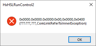

Now that I have access to the EntryExit library, I tried to make a simple method to test the module ((1) Initialize ML_STAR (2) Initialize EntryExit) but I am getting this error:
Run Control Error
This error does not appear when I’m running a method without the EntryExit library steps. I’m unable to look around in the Help documentation as the Method Editor software immediately freezes and crashes whenever I try to open any help dialogs for individual steps or libraries.

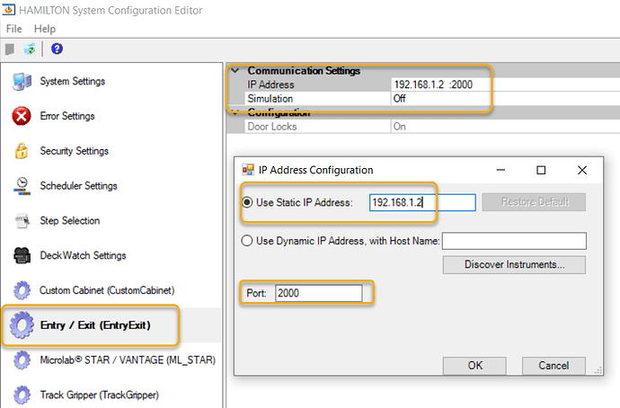

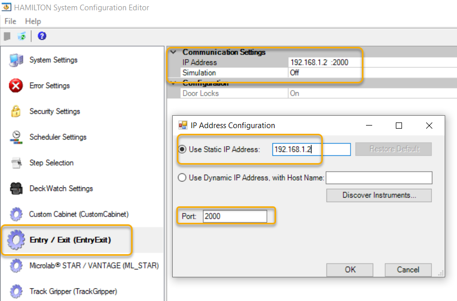

That error code means that there was not a successful connection to the assembly of boards that run the EE. The EE controller resides on a different network endpoint than the boards that control the pipettor, and as such they have a different IP address and port value. Run control will only attempt to connect to the EE if it has been added to the deck layout for the method being executed.
To enable connection to the EE, these network settings must be defined in system configuration editor.
It is extremely likely that the IP address for your EE is:
192.168.1.2
Port value is always 2000
The EE box on the bottom left of your screenshot is non-physical, it just indicates that an additional VENUS device has been added to the parent system for this deck layout. The labware definition of the EE top chute on the RHS of the deck will correctly locate the snapped labware in their associated stacks.
