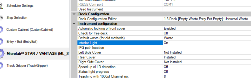

Will the lights reset if the system encountered an error?
If you are using VENUS 5/VoV rev T, or VENUS 6 for VANTAGE, you have a configuration option to use default light settings for the pipettor LEDs. This will set the light colors automatically based on run status, including error.
The custom lights library Eric linked can be used set the lights programmatically. If you use custom light commands from this library in conjunction with default light settings, I believe your custom light setting will be overridden on error, or other run status changes.
If you leave default light settings off in system config editor, the lights will behave only as you program them to.
