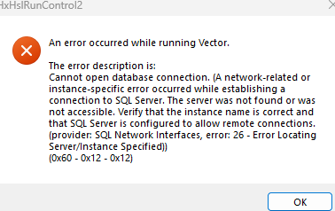

I do recall a little bit of fiddling to get the DB issue that @TechsupportCLS mentioned resolved, let me see if I can dig up what I did to fix that! I do all the sim development for methods on a windows 11 VM. I haven’t encountered any issues running methods in simulation, and they port over to the lab instruments that run windows 10 no problem.
Never tried controlling an instrument via the windows 11 VM so I couldn’t speak to how well it functions actually running a robot.
Update: I mentioned a few troubleshooting steps to resolve the DB issue in this thread.
This can be caused by a lot of things unfortunately. Some common things to check:
-Do you have full admin access on the account
-Was the setup rum as admin (right click/run as admin)
-Was the pc online
-Was the firewall and AV disabled
