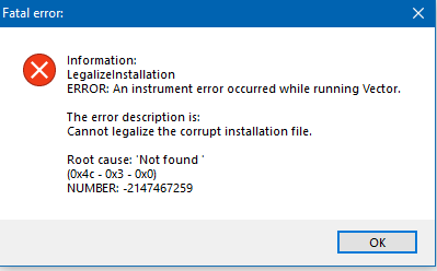

Earlier this week, I suddently was unable to run Method Editor.exe (v4). The process was not showing in Task Manager, and I doublechecked that antivirus software was not blocking the application. To troubleshoot, I went through the steps for uninstalling Venus as noted in the “Remove Hamilton Software” pdf.
Currently, I’m experiencing the error “Hamilton Cannot Legalize Installation” when running the Venus 4 installer. Note: I’m running the installer with administrator rights in Windows 10. The installer is being run from the .iso, version 4.5.0.5217:
Has anyone encountered the Cannot Legalize Installation error during installation? Is there a more detailed log file that I might be able to share to narrow down the issue?

Edit: Here is the exact error generated during installation:

Hi Kent,
Looking through the logs, it seems that SQL server, prerequisites, Phoenix (base VENUS SW components) and the ML_STAR driver components all installed correctly.
It could be possible that the installer isn’t failing until it gets to the very end of the process (asking for additional labware options to be installed etc) when it installs the ‘support software’ package.
Despite the error message, did the installation process yield a HAMILTON folder or any desktop icons? If so, then the support SW installation can be launched from method editor to complete the installation process.
If not we can take a step back and I can provide instructions for a full SW wipe prior to another reinstallation attempt.

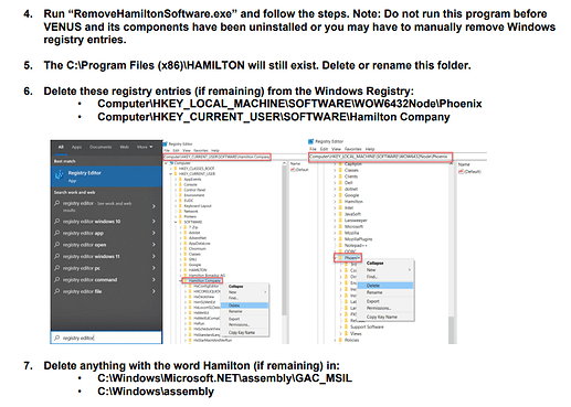

Hi Kent,
You can find full instructions here:
Note that these steps (in addition to complete removal of SQL server 2014 and its components) are of key importance
Link to Hamilton SW removal tool
If you encounter further issues after following the above process, it would be prudent to get you in touch with local support as troubleshooting installation issues remotely over the forum would become less efficient.
Let me know how it goes. Thanks.
Hi Nick,
Thanks for the instructions. I should have prefaced my post with the fact that I’ve been running the Hamilton Clean Tool before my reinstallation attempts. I may try asking the IT group if they can revert my PC back to a known safe restore point.

Hi there!
I am getting the same exact error as in ur screenshot stating cannot legalize corrupt installation file. Used the hamilton clean tool and followed the instructions for complete Venus uninstall before attempting to re-install again but still same error. How did you resolve your error?
Hi Raji,
I had to reimage the PC and then reinstall Venus 4 from scratch. After messing with registry key edits, Hamilton clean tool, etc, nothing was successful in resolving the error. I would be interested in root cause if you do find out.
