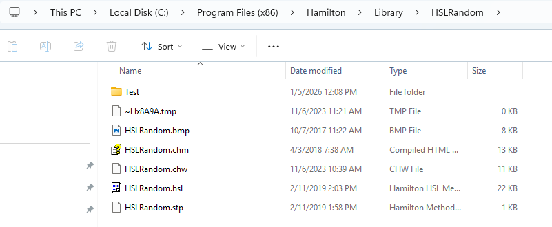

Thank you, Patrick! Does this mean that even though I see the HSLRandom library files in the Hamilton\Library folder, and there is no indication that the library is missing when I open the method in Method Editor, there can still be issues with library installation?
Hi @hpremathilake ,
Like @PatrickM mentioned, this error is a result of an installer being required. The library files are present, but there is a dll that needs to be registered for the library to work. Once the installer is run, the error should go away.
