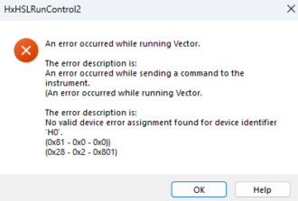

VENUS 6 iSWAP Error: "No valid device error assignment found for device identifier 'H0'. (0x81 - 0x0 - 0x0)) (0x28 - 0x2 - 0x801)"
While running a script that utilizes the iSWAP/iPG to transport labware across the deck, I ran into the following error: “No valid device error assignment found for device identifier ‘H0’. (0x81 - 0x0 - 0x0)) (0x28 - 0x2 - 0x801)”
I am currently running on VENUS 6, however, this same script had run as expected when we were operating on VENUS 4. This makes me believe it has something to do with VENUS 6. Any ideas on what the solution would be?

This happened during the iSWAP step and our system does have an MPH96 attached.
Stupid question, when you installed Venus 6, did you also make sure the firmware was aligned for Venus 6?
