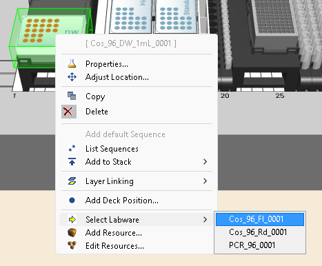

In 3D mode, when you right-click on a labware on a site with multiple labware, there is an option to Select Labware where you can select the one you want to view properties, adjust location, etc.

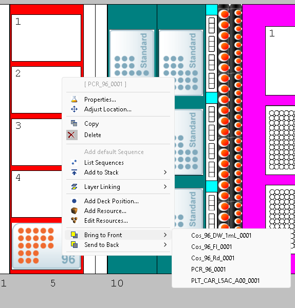

In 2D mode, you have the option to Bring to Front to select the labware you want.
As @PatrickM pointed out, you can also right-click on the deck layout (not selecting any labware at first) and you will have an option to Select Labware. This would return the entire list of labware though, which is functional, but not as intuitive as going to the site where the labware is located.
