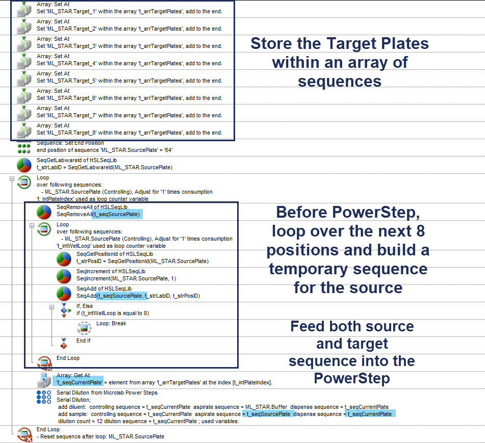

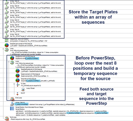

I am using MicroLab Power Steps in Venus 6.2 version. I am stuck at the moment trying the serial dilution power step. Is this dilution limited to only on sample? I have samples (64) in a plate and trying to take each column from sample plate and perform a serial dilution in a separate dilution plate. I added all the samples , diluent and dilution plates as sequence as part of the power step setup. When i run the method it just performs the serial dilution for the first column of samples and ends the method as complete. Am i missing anything? I confirmed that the Auto-increment is enabled for samples. No luck !
Hi @naveen ,
Sorry to see you are running into this issue. I was able to reproduce this on my end as well. This has been sent to our R&D team for investigation. It appears to be resetting the source sequence back to 1 each time and capping out the sequence for the first column which is why it stops at 1.
I was able to get around this by creating a temporary sequence for the current column before feeding that into the PowerStep and then looping that over the source sequence. See below for my example:
@BrandonBare_Hamilton Thanks for checking this. I was able to use the work around.

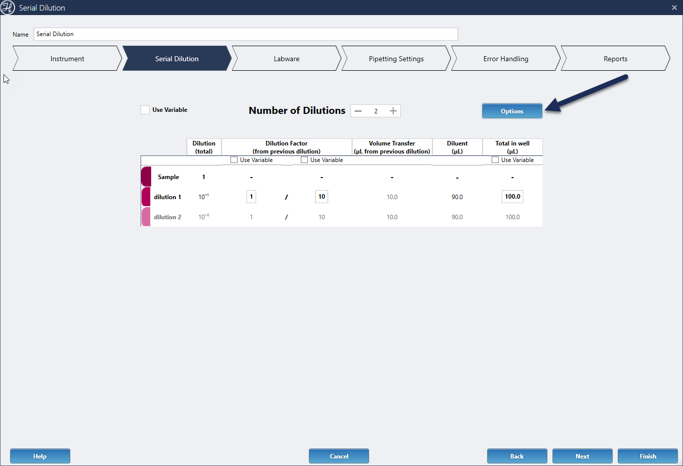

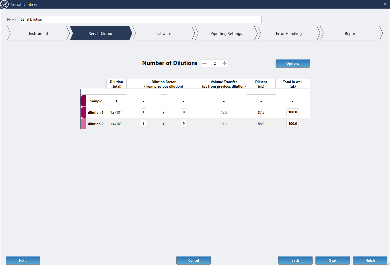

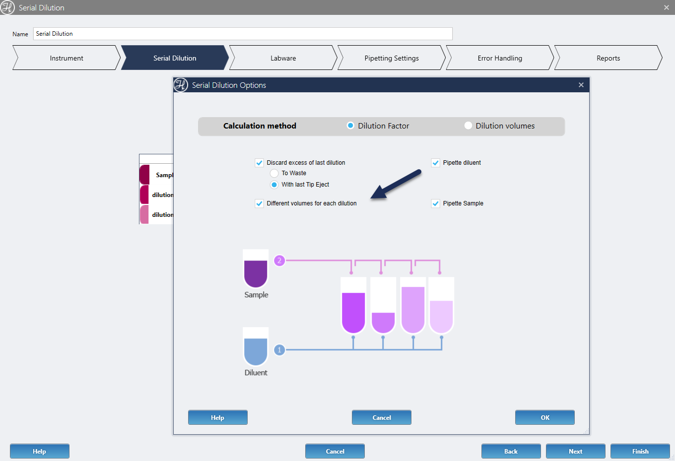

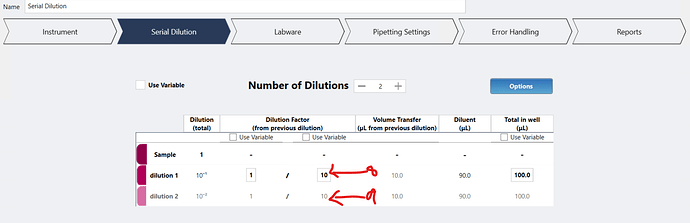

Question: Is there a way to use different dilution factor for each dilution in the power step for e.g. : use dilution 8 in the first dilution and 9 in the second dilution?
Hi @naveen ,
Yes, you can! If you click on the Options button and check the box for Different volumes for each dilution, this allows you to type in your individual dilution factors:
