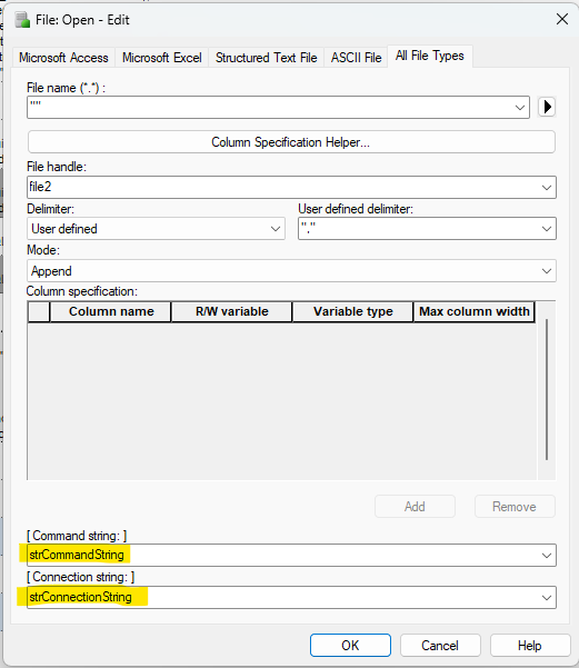

We use Hamilton’s Open File command to communicate with the database. If you are using SQL database, this is one approach that might work for you also.

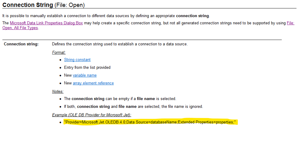

Get connection string - this will allow you to connect to your SQL database (it will look something like the highlighted yellow line in the image below - your LIMS Admin should be able to give it to you)

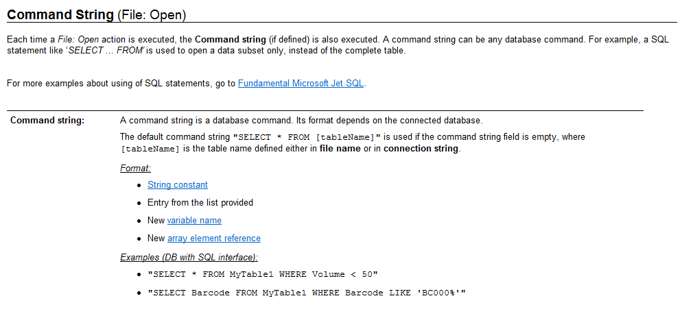

strCommandString - DB job that will run and write x,y,z variables (this needs to be established first on the DB side and this is where my expertise runs out, but the variable will look something like this:
strCommandString = “EXECUTE WriteToDatabase “var1”, “var2”, “var3”;” - this might need the use of HSLCode to clearly define this step, but very simply put, this job will run on the DB and write the information you’ve collected during the runtime.
You can put it inside of a sub-method and then have it loop in your main method based off whatever number of samples, or however you’ve defined your index.
That’s how we do it but there’s probably many ways like Stefan said. Also, I was able to make a local DB at home and make this work for a simple worklist using GPT to help me set up the DB using SSMS (SQL server management studio).
