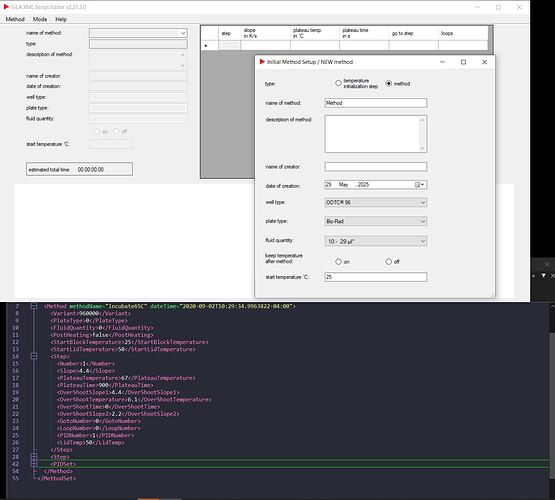

I am using the Hamilton/Inheco ODTC and was curious if anyone had any information/documentation on what each parameter is in the editor and how they correlate to the XML file. When entering in a target temperature, the editor seems to set a lid temperature in the XML file. How is this calculated and what is the difference between the lid temp and the plateau temp?

Thaks for the reply. I’m really looking to see if anyone has any documentation on how the software functions. The XML files have ~20 parameters in these configuration files, but in the editor software you can only directly set ~5. I can edit the XML files outside the editor but want to make sure I am staying within device bounds and function. As well as making sure the settings are the same as our manual thermocyclers.

I would also recommend reaching out to Inheco for the newest version of their script editor. From your image it looks like you are using version 2 of the script editor. Version 3 has a few more perks including being able to visualize what the real temperatures will be in the temperature v time graphs that each of your protocols generates. The real temperatures will include over and undershoots as your ODTC approaches a target temperature.
