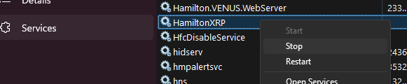

INSTINCT V requires the HamiltonXRP service to be running in the background in order to operate properly, however, this service also blocks VENUS on VANTAGE (VoV) from working correctly, leading to the error you’re experiencing. In order to use VoV, you need to Stop the HamiltonXRP Service:

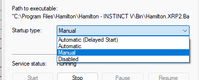

If you plan to work primarily in VoV at any point, then I suggest setting the HamiltonXRP Service ‘Startup type’ to Manual, so that it only starts when opening INSTINCT V (note, you will need to Stop the service again when switching back to VoV):
The above images are from the Services section of Task Manager.
This worked for me! Thank you @DanHartman_Hamilton
