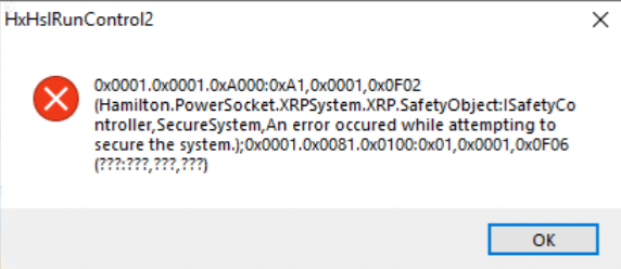

We are running into an error when trying to connect the track gripper on Venus on Vantage (4.6). We can access the control panel of the Track Gripper just fine but running a method is another problem. We instead get this error message with the corresponding the trace log (see below).

2024-12-04 11:30:07> Microlab® Star with Venus on Vantage : Main - error; An error occurred while running Vector.  The error description is: The instrument was unable to complete the command. (0x28 - 0x2 - 0x803)

Hi @Nat ,
This error is related to one of your doors being unable to be secured. Specifically, one of the doors in your B or D module. Double check that the doors are pressed flush with the sensors and not slightly pulled ajar.
It is possible that during the move the door sensor/lock may have become unaligned. If this is the case, you will require a service visit to realign.

Thank you for the help! It appears that the door sensors on the logistic cabinet is not working anymore as we can also confirm the error on Instinct V. :frowning_face: We are reaching out to the service team but is there anything we can do to bypass this error and still use the gripper in the meantime?
-Nat
Hi @Nat ,
Unfortunately, as long as the Track Gripper is attached to the layout, the connection to the instrument will attempt to lock the door.
