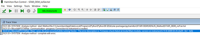

Amazing thread! @EricSindelar_Hamilton - how to we perform firmware upgrades? We’re running into this error on a couple STARlets we got at auction & can’t get them to run via Hamilton Run Control due to this error: (it still executes direct firmware commands with no issues)
Firmware check failed at modul Main module. version on instrument is 6.1S B 2009-03-25 (0x29 - 0x1 - 0x9)
You can reach out to the Hamilton Service Hotline at 1-800-527-5269 or roboticservice@hamiltoncompany.com to determine what support we can provide. We do not provide firmware or upgrades free of charge and without the oversight of trained personnel. Uploading incorrect or incompatible firmware could damage the system.
Can we get a link for people alright with damaging their systems? Just so others who google this problem in the future can solve it without asking for help from someone with access to the right files
I’m sorry, but it is not our policy to share firmware as it creates too much risk due to misuse.

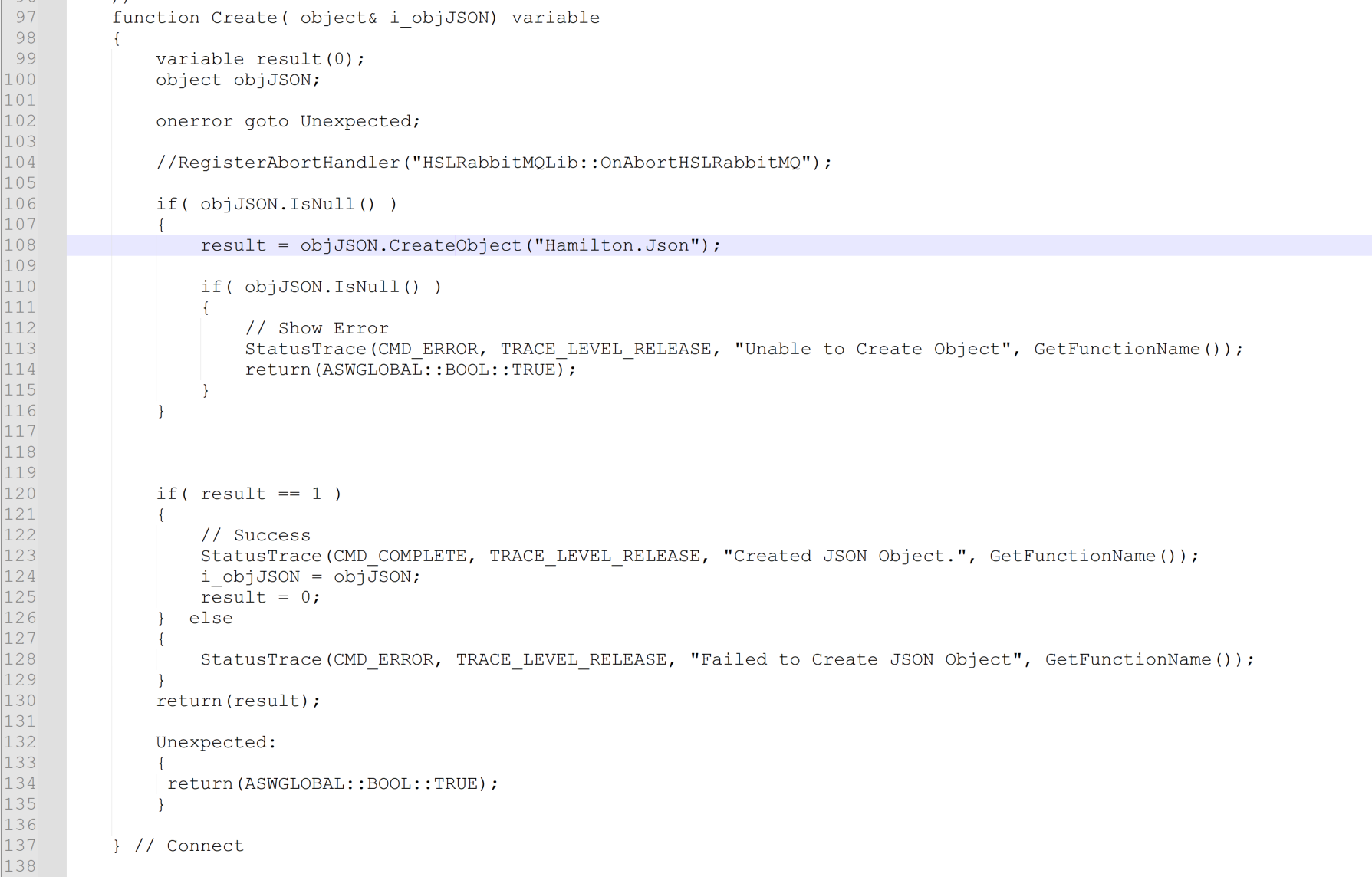

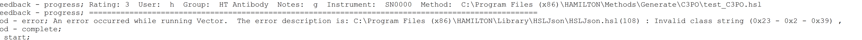

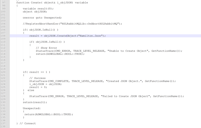

I’m having trouble using the Create function. I just get the error “invalid class string” do I have an outdated JSON library package?
@smohler @max_gildemeister - ‘Invalid class string’ is thrown when VENUS attempts to reference required components that have not been added to the windows registry. Typically, this occurs when attempting to use a library that requires an installer, in addition to the HSL files for the library.
If you imported the HSL, but haven’t run the installer, this will occur. I’ve linked it here.
This is the latest version, so you may want to delete your current ‘\HAMILTON\Library\HSLJson’ folder first.
