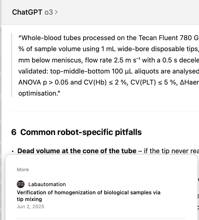

I have a lot of experience with blood but I was curious and asked o3 to see what it would suggest. Anyway look at this source that it used,
