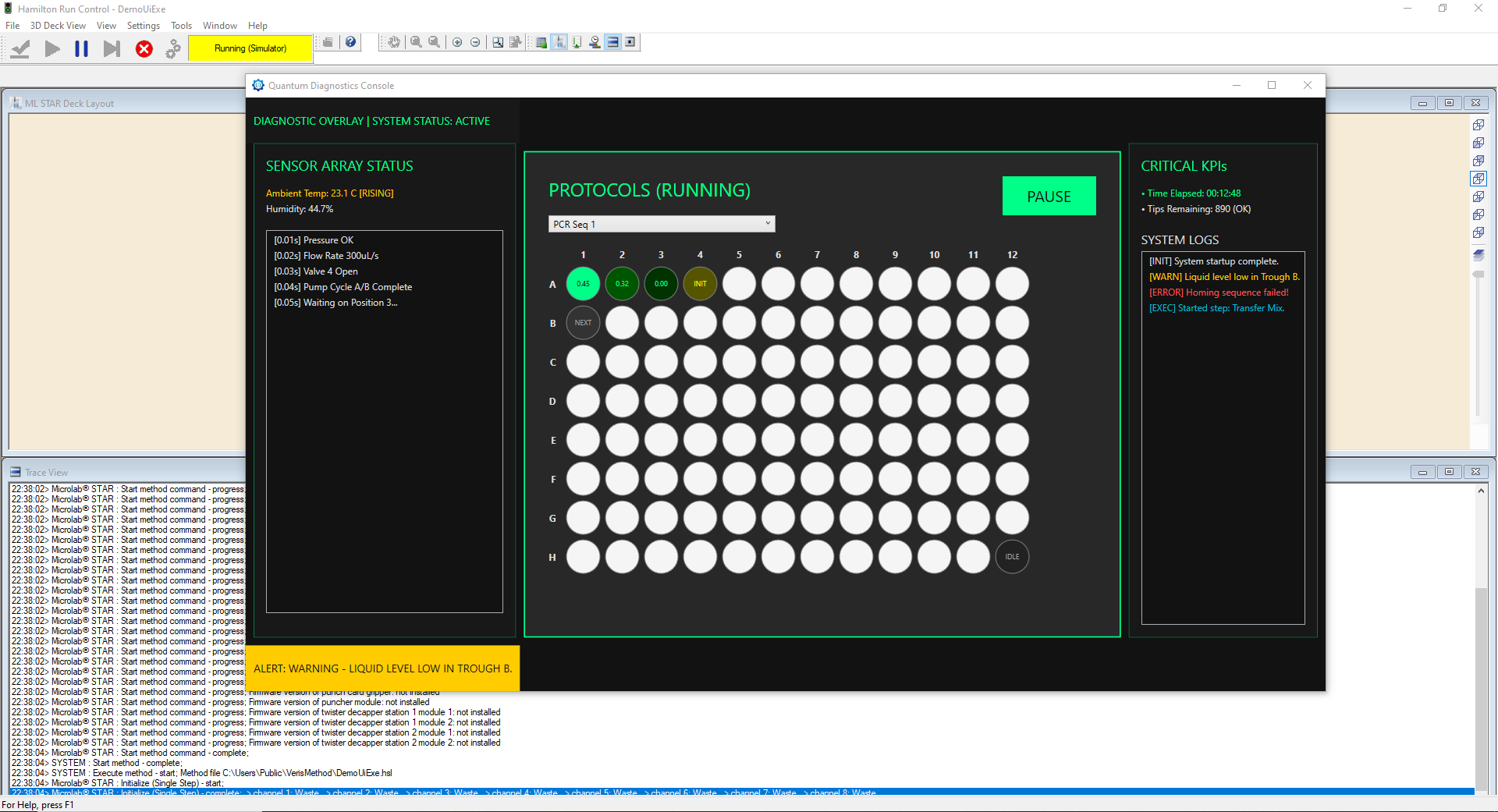

:framed_picture: UI Preview
Here are examples of interfaces rendered via the generated configuration file:
