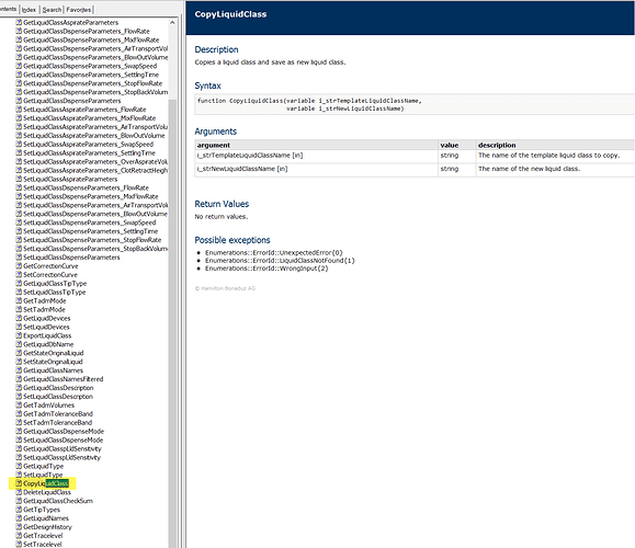

Hi Zach,
It looks like you might be using an older version of the liquid class library. I think you will find the new version will better suit your needs. This library exposes basically anything one would want to do with a liquid class, along with comprehensive help documentation.
For your case, you likely need to use the ‘CopyLiquidClass’ function, which would be use to copy an existing (arbitrary) liquid class, to be used as a container to receive new LC parameters. This function will save the copy as new, and I assume automatically create a checksum as part of the copy.
Hope this helps!
