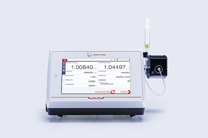

I have measured viscosity and density for liquid class development. It was useful for gravimetric measurements of dispensed volumes and understanding why one liquid would behave differently than water.

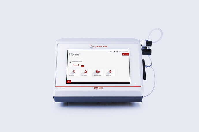

I used the density viscosity meter combo from Anton Paar. I believe there is some limitation with sample recovery and incompatibility with certain reagents.
Interesting, I was also looking at another Anton Parr product as well.
Any specific reason for selecting that viscometer over their other offering?
Thanks by the way for the speedy response
Their customer rep was responsive and willing to work with me on my application. They let us use a demo instrument to confirm that it works for our purpose. We also ended up getting the IQ/IQ and a year PM from them.
They’re an established company and the rep for my area worked with mainly wine and beer so they were excited to work on a biotech application.
I don’t think I saw any other company with the same combo instrument because I think Anton Paar has the patent on their density meter.
Their other viscosity meters I believe are built for liquids/substances that don’t work with the one I linked. I believe the density model differentiators are the accuracy. How much are you willing to pay for an extra decimal.
