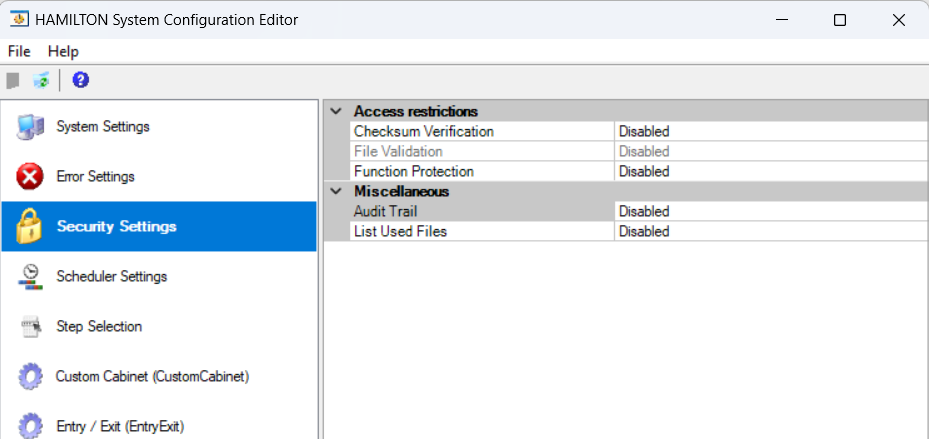

Ahh yes, you are right. As most of my work is with R&D I have the checksum verification off:
You probably will have to make a small edit in the HxHslMetEd.exe for the checksum to be auto calculated for your use if your lab requires it.
Ah yeah of course, I forget that in certain environments you have the permission to just turn those checksums off!

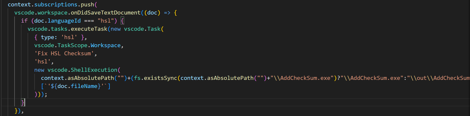

I added the function of generate checksum after saving of hsl file. This can be done in C# with about 2 lines code
            var security = new HxSecurityCom() as IHxSecurityFileCom2;
            security.SetFileValidation(args[0], 0, "//");
and execute this tool after file saving, then we can add checksum to hsl file
Updating the checksum at the end of the file has been added as a feature! Thank you @Huajiang for your contribution!
